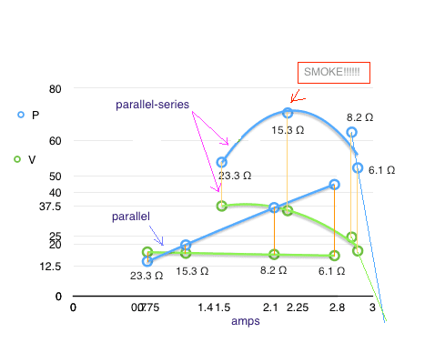

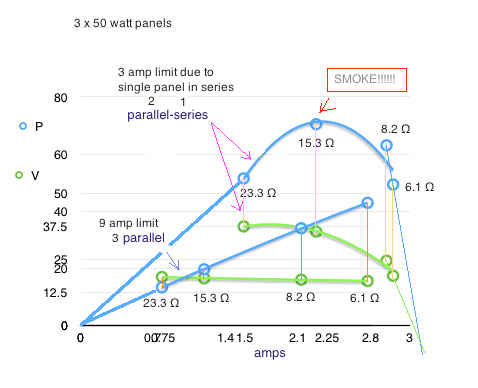

Interesting question.
My guess is no.
ps. I'm not willing to do the experiment, as I only have 3 of 4 of my original solar panels left.
pps. Here's a graph of me trying to analyze my PVs last summer:

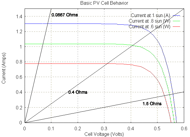

Typically solar panels are rated for max power, open circuit (max) voltage (I=0) and short circuit (max) current(V=0).
Below is a typical characteristic curve for a solar cell for different light intensities with different loads showing the resulting currents and voltages. The max power occurs near the top of the knee around 0.8 Vmax. You can see that the power produced is highly dependent on the choice of load resistance.

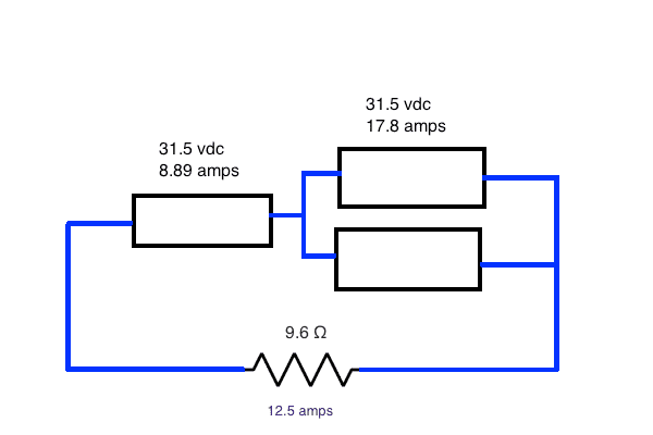

It seems to me that we've exhausted the ohmic logic here.
Solar panels are not ohmic devices. They are ≈constant current devices on one end of the curve, and ≈constant voltage devices at the other end of the curve.
I really liked mcharbs55's question; "Is there a way to hook these things up, like resistors, or batteries?" [paraphrased]
The above schematic is grossly simplified, in the context of this question, of course.
The question is, "Does the single panel on the left, limit the current capability of the two panels on the right?"
I spent about an hour yesterday trying to find an answer, and could not find one.
Hence, my "No" guess.
ps. I have no idea how solar panels work, other than; "quite well".
pps. If the panel on the left is NOT capable of carrying 17.8 amps, then the problem becomes very trivial.
Likes sophiecentaur

We haven't heard from the OP regarding suggestions. The characteristic curve of the chosen solar panel must be consulted from which you choose the appropriate resistance for maximum power. Trying to fit the panels to the element is not a good approach. If the resistance is too high you kill the output.
We do not know what kind of project this is, a DIY hot water heater or a science project. One might possibly consider an alternative method of heating the water using a passive heating system and a solar cell driven pump to circulate the water which will use much less energy . Solar cells are only about 20% efficient.

ps. The sun is in and out today. I may do the experiment I was referring to earlier.
Likes Asymptotic
hmmmm...
Looks like I guessed correctly.

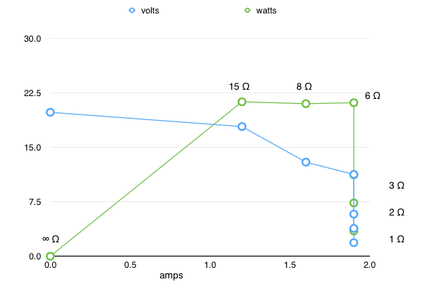

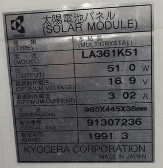

Interesting how Kyocera's "optimum current" matches the power and voltage with current intersection point of my graphs so well.
Guessing by "optimum", they meant maximum.
Actually the optimum voltage is that voltage that gives the maximum power output for the maximum sunlight. The max voltage occurs at zero current which is about 25% higher.
Likes OmCheeto

But anyways, just scratching my head, I can't figure out what the minimum number of panels is to boil the water.
One moment...
In series, the answer is 6 panels. (189 VDC @ 8.89 amps)
In series-parallel, the answer is 8 panels. (126 VDC @ 13.13 amps)
With a power optimizer circuitry, the answer is 5.4 panels, which is effectively 6.
So, I guess I'm done experimenting, and have learned something.
ps. Good lord I'm slow. I just realized why with the 3 panels in parallel, the voltage and power graphs didn't droop. There's a 9 amp limit!
hmmmm... Maybe I will do more experimenting. I'll bet I can make my resistors REALLY smoke. :biggrin:

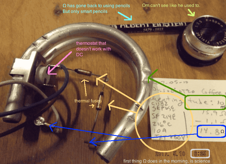

pps. Regarding a comment in mcharbs55's "Solar panels & coffee pots part 1" thread:
Asymptotic said:
One thing to keep in mind - manufacturers often specify wattage rating at operating temperature. Heater element wire has a positive temperature coefficient (often abbreviated as 'tempco') which means resistance increases as temperature increases, so don't be alarmed if an ohmmeter measurement at room temperature yields a value somewhat lower than the calculated 9.6 ohms.
I have a Kill-A-Watt meter, and measured the power consumption of my coffee pot. I also measured the resistance of the heating element. I did not notice an appreciable deviation in wattage from what I calculated it should be from the "no load" resistance. My guess is that the heating element temperature did not go much over the boiling point of water.
hmmmmm... This gives me an idea for experiment #4.
