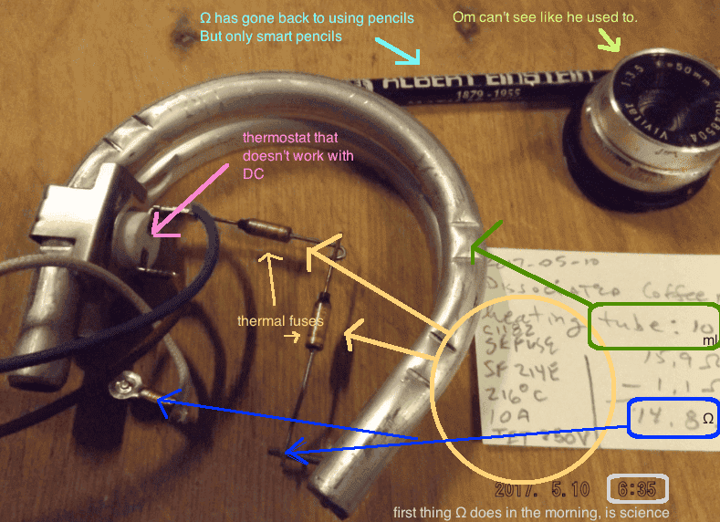

The AC only ratings are probably dictated by thermostat switch contact ratings. A typical rating is 250V/10A, 125V/15A for AC, but unrated for DC (or, if it is, it would be limited to 30 volts at the 125 VAC current rating). The arc that occurs when the contacts open extinguishes when AC crosses zero volts, but a DC arc sustains until their separation distance becomes great enough. Not only does this generate a lot more heat, but in a physically small switch like a thermostat the distance between contacts may never open up enough to fully extinguish the arc, and they'll melt in short order.

Yesterday I determined that my solar panels have indeed lost 0.4% of their capacity per year.
This morning I measured the capacity of the heating element system from a coffee pot that one of my neighbors gave me last year. The coffee pot didn't work, even though it was manufactured ≥ 2009. Being that the "electronics" portion of the pot was toasted, from the discoloration of the printed circuit board, I decided to keep the heating element, and recycle the rest.
Anyways, the capacity is 10 ml, and the element has a resistance of 14.8 Ω. (same as my current drip coffee maker)
I calculated that one of mcharbs55's solar panels can boil water in the tube in 33.3 seconds, which is about 10 times longer than for my 1970's coffee maker(3.6 seconds @ 120 VAC).
This took a bit of finagling, as plugging in the max wattage, produced an excessive voltage:
280 watts @ 9.6 Ω yields 5.4 amps(ok, 8.89 amp limit)
but 51.8 vdc(not ok, 31.5 vcd limit)
Which is, I believe, what mcharbs55 was asking about, in the original post.
So, another answer is: It only takes one mcharbs55 panel to boil water. It will just take longer.

Experiment #1 was quite easy: No matter how long I waited, my single solar panel would not heat the water past a certain temperature.
If anyone would like to figure out my thermal losses, whilst I take my nap, here are the equations from the data I collected yesterday. 3 x 50 watt 12 vdc panels wired in series:
temp climb
K = -0.0006 * sec^2 + 0.4865 * sec + 295.77​
temp decay
K = 661 * sec^(-0.11)​
No load voltage measured was 55.1 vdc.
ps. Obligatory picture, of how science is not always pretty:
