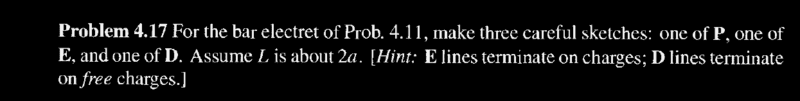

##σ_b = \vec P ⋅\hat n
The polarized system could be transformed into two charged discs S1 and S2 of radius a kept at a distance L.
The discs S1 and S2 have surface charge densities -P and P respectively.
A) For L>>a,
In this case, the system could be approximated as two equal and opposite charges kept at a distance L.
So, the Electric field can be sketched as
B) For L << a,
The system could be approximated as a capacitor.
So, the electric field inside the two discs will be uniform.
And the electric field outside the two discs will be in the direction from the positive plate to the negative plate. I can't say anything more in this case.
C) For L ≈ a,
The electric field is perpendicular to the plates in the direction from positive to negative plate in the vicinity of the center of the plates.
But, in the region far from the center, I can't say anything.
Here, I need help.
##\vec P## is along the axis of the cylinder.
##\vec E ## can be sketched as a curve line from positive plate to negative plate.
How to sketch ## \vec D ## as there is no free charges?

Another view: put a very thin right circular Gaussian cylindrical surface coaxially with the electret. One end goes to infinity, the other sticks inside the electret. What is D integrated over the whole surface equal to? So then what must D be for the end that sticks in the electret?
The system has "frozen - in " polarization. This means : initially the cylinder was placed in the presence of external electric field, it got polarized with polarization up to ## \vec P ## and then the external field was removed. Now , this cylinder with Polarization ##\vec P ## is our system.
So, I have to calculate ## \vec D ## due to this polarization.

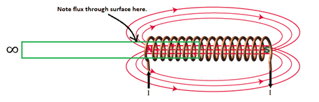

As an analogy, replace the electret by a solenoid of the same shape. The divergence of B is zero everywhere. So, the flux of B through any closed surface must be zero. In particular, if you choose a gaussian surface as you did for the electret cylinder, then the total flux of B through this surface is zero. But, we know that B is not zero inside the solenoid.
If you choose a gaussian surface as you did for the electret cylinder, then the total flux of B through this surface is zero.
Yes, I choose so as I think there is nothing wrong in choosing this Gaussian Surface. So, the flux through the end surface inside the solenoid is 0.
As the magnetic field is along the axis and constant, I can take it outside the integration, which gives zero magnetic field.
So, something is wrong with this argument. This I understood.
But what is wrong?
But what is wrong?

TSny said:
Sorry, I couldn't understand the answer given in the picture.
While applying Gauss's law ,
I took the flux through the curved surface to be 0. This is the mistake. The flux through the curved surface is not zero.
If the solenoid is infinitely long and I take a small cylindrical gaussian surface inside the solenoid, then the flux through the curved surface is 0. This gives us the information that the magnetic field inside the solenoid is constant.
Right?
Yes.
Right?
It shows that the magnitude of the flux through the two flat ends of the gaussian surface are equal. So, it shows that the average of B over a cross section of the solenoid is independent of the choice of location of the cross section. That is what you would expect from symmetry for an infinitely long solenoid.
Inside the cylinder, ## \vec P ## is uniform. So, ## \nabla \times \vec P = 0 ## . Outside the cylinder, there is vacuum. So, ## \vec P = 0##.
Hence, ## \vec P ## is 0 everywhere. Isn't it?
I don't follow your conclusion: "Hence, ## \vec P ## is 0 everywhere".
The important thing is that ## \vec P ## suddenly goes from a nonzero, uniform value inside the cylinder to a zero value outside. This effectively makes ## \nabla \times \vec P ## nonzero for points on the curved surface of the cylinder. Think about the line integral of ## \vec P ## around a closed path that straddles the curved side.
