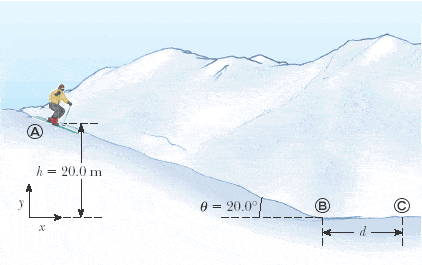

Problem A skier starts from rest at the top of a frictionless incline of height 20.0 m which makes an angle of 20 degrees with the horizontal. As the bottom of the incline, the skier encounters a horizontal surface where the coefficient of kinetic friction between skis and snow is 0.210.
Find the horizontal distance the skier travels before coming to rest if the incline also has a coefficient of kinetic friction equal to 0.210.
-mg(mu) cos 20 = -1/2 mv ^2
-g cos 20 = -1/2 v ^2
unable to get the right answer...pls help

thanks...i tried again with sin instead of cos and it didnt work out...there is friction on both surfaces...as it says on the last line "if the incline has a co-efficient of kinetic friction"...can u solve it showing all the steps...thanks

I have no clue about the method that u mentioned...atleast if you could show me the equations, i can try to work out the solution...gh alone would be 9.8 x 20= 196...i am attaching an image of the problem...would appreciate if you could provide the equations and i can take it from there...thanks
(I can't see your picture yet, but anyway …)
The gravitational work done is mgh, because mg downward is the force, and if we "dot" it with the displacement, that means multiplying it by the difference in height, h.
The frictional work done must be calculated separately, and is the friction force "dot" the displacement …
what is that? :smile:​

thanks a lot...i got the correct answer using the equation:
0.210 x 9.8 x height = 0.210 cos 20 x horizontal distance of incline + 0.210 x 9.8 x distance traveled totally
