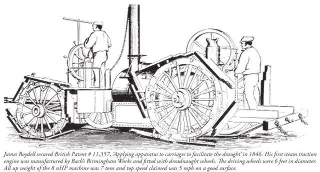

I found another image of a Dreadnaught wheel:
Engraving of James Boydell's steam traction engine with large spoked driving wheels fitted with dreadnought wheel paddles, a chimney, and two men standing on the machine.
I see better how the shoe/pad/rail are linked to the wheel. The shoes are loosely attached to the wheel. The shape of the hanger is only for proper positioning of the shoe for 'entrance' between ground & wheel (going forward or backward).
Imagine the wheel-side of the shoes are slippery as ice, but the ground-side are sticky as rubber. When the wheel sits on a shoe, there is enough play to permit slipping between the wheel and the shoe. But once the play is gone, the peg of the wheel will mechanically 'lock' with the hanger of the shoe and further slipping (if any) will be between the shoe and the ground. As I said earlier, slipping can occur at both levels, even simultaneously.
I still don't see how this relates to a tire where the belt is mechanically bonded to the tread. The way you made your statement, it suggests that if the treaded part of a tire was as thick as its belt radius for example, that it would have no effect on the speed of the axle. If this is what you meant, I can't see how I can agree with that.
Another example: When a tire is freely spinning on its axle (burnout, ##v_{CM}## = 0), the slipping obviously happens at ground level, and there is no slipping between the belt and the tread. Why would I use a smaller length than ground-axle distance for reference?
Not quite. The detail is important but rarely reported.
Two Geriatric Loonies said:
“One cable was doubled; it wound onto the wheel rim to haul Lizzie along. The other cable was single. It was connected to the opposite end of the track. Together the tensioned cables held the track firmly against the rim while leaving it free to rock.”
Text and pictures at; http://pete-n-pam.com/main/061_080/page063.htm
The two tensioned cables for each shoe prevented rim slip on the top of the shoe. The looped cable symmetrically balanced the cable tension against the shoe, while still allowing azimuth rotation when cornering. Any slip with the Dreadnaught wheel must occur between the shoe and the ground.

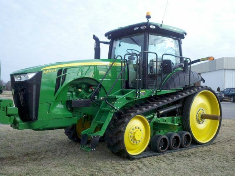

So what is the wheel radius of a tracked vehicle? The length of the track divided by 2##\pi## ?
Photo of a green and yellow John Deere 8310RT tracked tractor with rubber tracks and yellow wheel rims, parked on grass in front of a metal building.
jack action said:
So what is the wheel radius of a tracked vehicle? The length of the track divided by 2 pi ?
It is clearly not track length / 2Pi.
Tracks normally have a sprocket drive that should not slip. I think I can see a central line of lugs in the picture that run in the central groove of the drive wheels. The track then becomes the equivalent of Dreadnaught shoes, or of the block tread on a pneumatic tyre.
To be accurate we should count the number of teeth on the sprocket and measure the pitch of the rollers on the track. Rolling circumference = Number of teeth * Pitch. Divide that by TwoPi to get the effective rolling radius.
In the case of the John Deere pictured, there are teeth moulded onto the inside of the rubber track, but I cannot see where the sprocket might be hidden. It does appear that the track is driven as per normal, at the rear.
Nevermind, After writing that last post I got to think more about it and realized my mistake I turned off my computer just after writing that post yesterday, but I'm correcting it today.
The reason why the tire radius doesn't change is because no matter the shape of tire belt, whenever the wheel makes one revolution, the belt travels its entire length and comes back to its original starting point. Thus the traveled distance per revolution by the tire is always the same. It's the flexing side walls that permits such characteristic, a feature that tracked vehicles don't have. So you have to treat them solely as belts or chains.

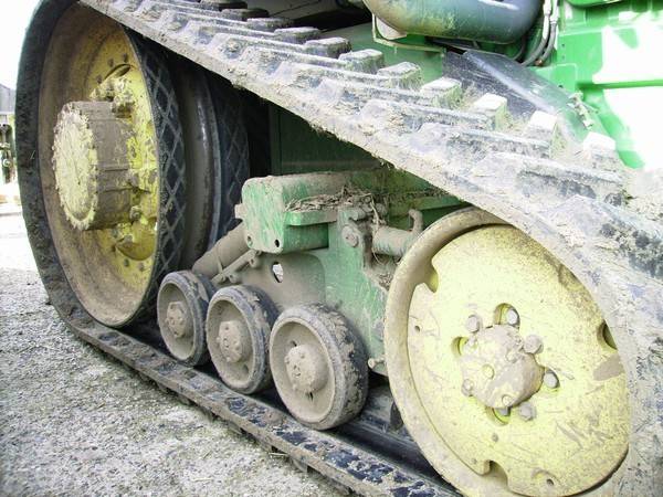

For the John Deere, I think it relies on friction (rubber on rubber), like a belt. The "teeth" you see are only there to take side force and keep the track aligned with the wheels. This picture is more clear:
Close-up of a green tractor's rubber track undercarriage, caked with mud, showing the track belt, road wheels and a drive sprocket on the side.
Diagram titled Tutorial showing a wireframe funnel-shaped surface with concentric ring outlines narrowing downward, with a red line and a cluster of green and yellow geometric shapes at the bottom.
That is the fundamental principle behind the rolling radius of pneumatic tyres. I believe it is the radius that should be used when computing slip.
That second picture is actually a different system. It does not seem to have the independent rocking track assembly and split wheels. Maybe it is friction drive, with a hydraulic track tensioner to prevent track drive slip.
