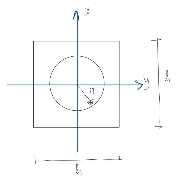

Hello everyone, I hope you can give me hand with what I will present.
I have a beam with cross-section shown below.

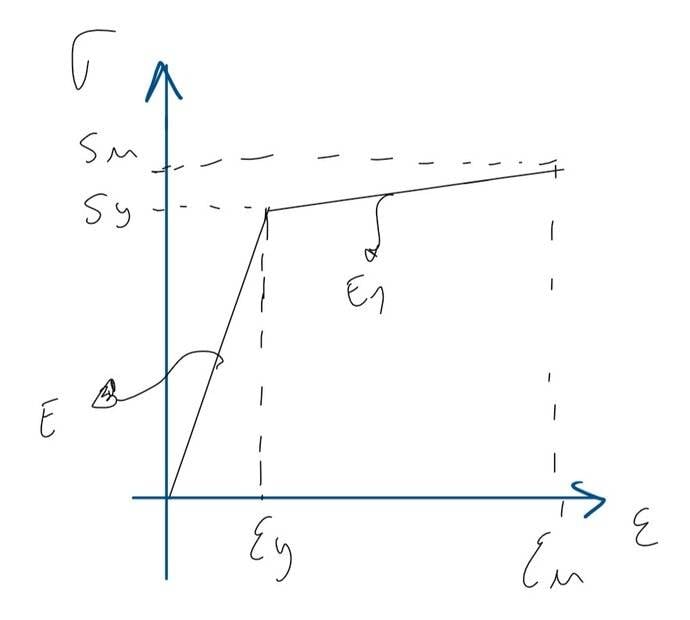

I considered a simple linear hardening model for predicting the stress and strain developed by bending the beam on the radius ##R_0## around the y-axis, where:

Where and ##\varepsilon_y = \frac{S_y}{E}##, ##S_y## is the yield strength and ##E## the Young's Modulus.
##E_1## is the tangent modulus which is defined as shown in the picture below.

Where ##b(x)\cdot x## is the cross-sectional area of the beam and ##b(x)## is defined by:
##b(x) = \begin{cases}
h-2\sqrt{r^2-x^2} \mbox{, if } x \leq r\\
h \mbox{, if } x \gt r
\end{cases}##

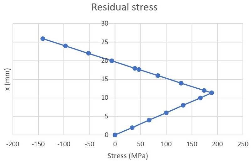

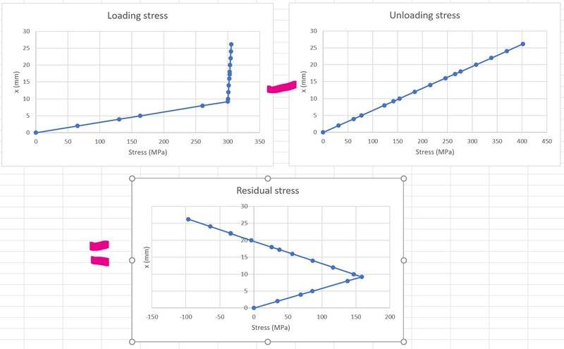

Ah! I had an enlightenment moment! (I think!)
What I calculated, ##M_b##, is in fact the bending moment accounting the springback effect, i.e., taking into account the release of the stored energy. This means that, ##\sigma_b## will give me the stress in the beam after unloading, right?
Therefore, the residual stress, ##\sigma_{Res}##, will be just the difference between ##\sigma_L## and ##\sigma_b##:
##\sigma_{Res}(x) = \sigma_L(x) - \sigma_b(x)##
I made a quick plot in Excel, and I think the results look good (at least compliant with the literature).

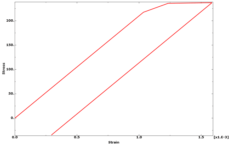

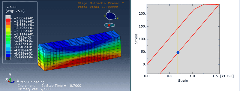

Here's an exemplary stress-strain curve obtained from FEA of a simply-supported rectangular beam subjected to uniformly distributed load (the material model was bilinear with hardening):
As you can see, the unloading part is linear and parallel to the loading one. What's more, stress changes sign at the end of unloading.

@FEAnalyst : That's a strange loading diagram in that the stress rises instantaneously at zero strain. I don't know of any materials like that. I don't think I'd call it exemplary.
Also, there is nothing in FEA that can create a stress-strain curve, other than what the code writers built into the software.
@FEAnalyst I haven't used any particular book, I got this elasto-plastic formulation from browsing the web.
I started from simple assumptions, like a bilinear elasto-plastic stress-strain "curve" as the one I defined in the first post. Then, a simple linear hardening model to match it:
##\sigma(\varepsilon) = \begin{cases}
\varepsilon E \mbox{, if } \varepsilon \leq \varepsilon_y\\
S_y + (\varepsilon - \varepsilon_y)\cdot E_1 \mbox{, if } \varepsilon \gt \varepsilon_y
\end{cases}##
I have defined ##E_1## to be ##E_1 = 0.01 E##.
Then, I found somewhere a nice relationship (which should have been obvious) between the bending radius and the strain developed in the beam, allowing you to switch from the strain and define the stress in terms of the beam dimensions:
##\varepsilon_L(x) = \frac{x}{R_0}##
Which then results in the formulation I have also defined in the first post:

Then, what I did was the following:
  1. Computed the required bending moment using the integral ##M_b=2\int_0^{h/2} \sigma_L(x) b(x) x dx##, to get my desired radius after springback, ##R_r##, and taking care of the different elastic and plastic regions;
  2. Computed the stress profile, ##\sigma_b(x)##, due to the bending moment ##M_b##, which in fact corresponds to the unloading stress (after springback) by simply doing: ##\sigma_b(x) = \frac{M_b}{J}x##;
  3. Using the loading curve defined by ##\sigma_L(x)##, I managed to create the stress profile for ##\sigma_L(x)##;
  4. The residual stress profile, ##\sigma_{Res}(x)## is then computed by doing ##\sigma_{Res}(x)= \sigma_L(x) - \sigma_b(x)##.
The hardest part was to calculate ##M_b## due to the strange geometry I have, which led to non-trivial integrals. But Mathematica helped me with them.
The stress profiles for ##\sigma_L(x)## and ##\sigma_b(x)## are in my previous post. But please be aware that they are not stress-strain curves! They are defined in terms of the beam cross-section geometry.
Hope this helps!
Could you attach a simple sketch showing how this should look like ? Maybe something must be changed in the approach to this simulation. Load was ramped (uniformly increasing) in the first step of the analysis. Stress-strain curve was obtained by combining the total normal strain in the direction of beam axis with normal stress in the same direction. Both stress and strain were read from the bottom most layer of elements in the middle of the beam and averaged.
@freddie_mclair Thank you for sharing your results.
Assuming no residual stress at the beginning, the stress-strain curve should pass through (0,0). There is no physical mechanism by which it can then jump to a positive stress value with no strain.
But it starts from (0,0):

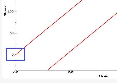

You are correct about it starting from (0,0); I failed to see that. I assumed that the horizontal axis line was at zero stress; that's the way I've always seen it plotted.
This raises the question, however, about what does it mean at the other end where the stress goes negative?

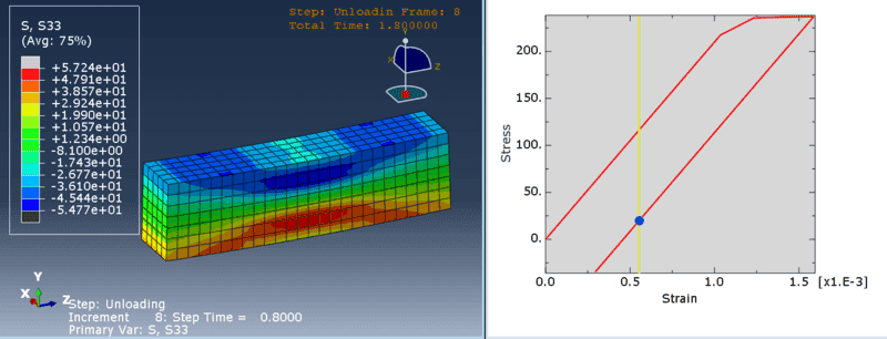

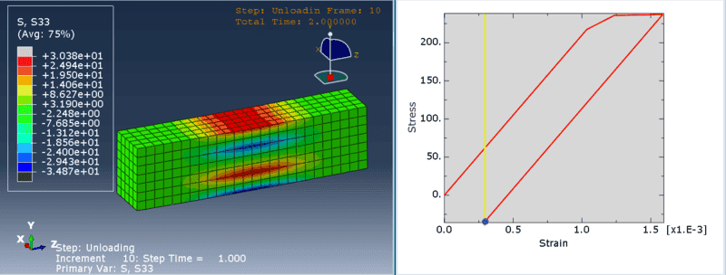

I was also wondering why the stress changes sign at the end of unloading.

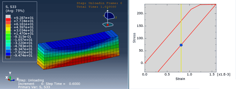

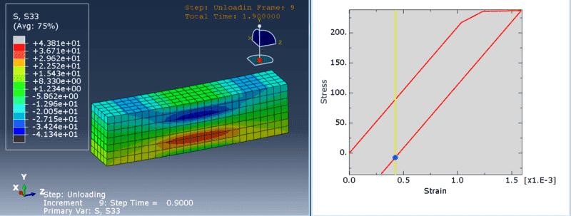

Here's what happens with normal stress in the middle part of the beam at each frame during unloading (contour plot is synchronized with stress-strain curve and the dark blue dot shows the current location on the curve):
In the last two frames stress has different sign. Maybe those pictures will let you interpret the behavior of this model.
P.S. Unloading analysis step was realized in such a way that the load was removed gradually throughout this step allowing the beam to regain its shape (at least partially since there's also some permanent deformation).
the negative stress appears to be the residual stress after relaxation. Seems you are plotting not the middle of the bar (which would be right along the neutral axis) but perhaps the middle of the the lower surface; it's put in tension during the bending, would be in slight compression after unloading.
I'm curious as to how we are defining "residual stress on a beam" - peak?. I would suspect that the total residual stress state would be geometrically distributed and would want to find an equilibrium (obviously this isn't mathematically precise); there would be contributions from both tension and compression as seen above.
Yes, I took the stresses from elements in the bottom most layer and averaged them. And when I was talking about the middle of the beam, I actually meant the middle between the supports (in the beam's longitudinal axis).
FEAnalyst said:
...bottom most layer ... middle between the supports (in the beam's longitudinal axis).
that makes sense

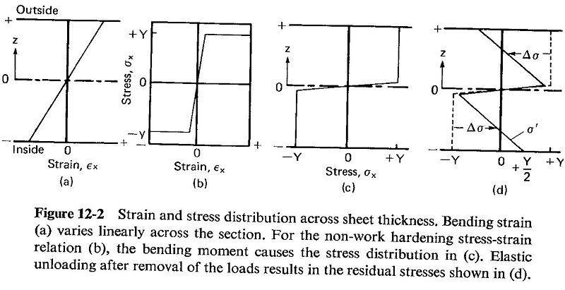

This diagram, from Metal Forming - Mechanics and Metallurgy by Hosford and Caddell, shows how to calculate residual stresses after plastic bending and force removal for a simple elastic-plastic material:
It is used in springs to reduce peak surface tensile stress under load. Search term preset (or presetting) springs to learn more.
A basic calculation in sheet metal forming is to calculate the amount of springback when bending sheet metal. The above diagram is for simple bending. The calculation is even more fun when calculating bending under tension for the purpose of reducing springback.

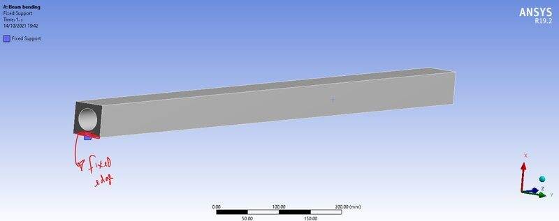

Hi! Thanks a lot!
I think it could be very interesting if you could model with FEA what I have modeled analytically on my first post.
The cross-section geometry is the one I defined in my first post: it's a squared section with ##h=51.9\mbox{ mm}## and a circular hole with a radius of ##r=17.65\mbox{ mm}##. The bending radius (before springback) is ##R_0=4917.65\mbox{ mm}##; from my analytical model, after springback, I get a radius of ##R_k=11707.5mm##.
The peak stresses I get are the following: ##\sigma_{res1}=190\mbox{ MPa}## at the elastic-plastic core boundary and ##\sigma_{res2}=-140\mbox{ MPa}## at the outer surface of the beam. Here's the plot I get (I only plotted half of the beam, the other part is symmetric):

Sorry, I forgot to mention the mechanical properties of the material (SS 306LN):
- Yield strength: ##S_y = 450\mbox{ MPa}##
- Young's modulus: ##E = 190\mbox{ GPa}##
- Tangent modulus: ##E_1 = 0.01\cdot E##
To model this I would also need to know what are the boundary conditions (simply-supported beam ? cantilever ?), length of the beam and loading (type and magnitude).
And one more thing - ultimate tensile strength with elongation at failure, if you have it.
That should suffice.
Hello!
Sorry for the delay on my reply!
I don't know the tensile strength and elongation at failure.
For the load, I'm not sure the best way to define it. My model is independent of the load. I was able to calculate the total bending moment by just considering the required bending radius. The total moment I get is:
##M_b=12 \mbox{ kN m}##.
But, I'm not sure how to translate this bending moment to a load... should we just consider a point load in the middle of the beam? If we do this, then the load would be ##P=4M_b/l##, where ##l## is the length.
Now, for the setup, I would use a simply supported beam. For the length, I don't know, mainly because my model is length-independent. I have only checked the cross-sectional stress distribution. I think a 1meter beam should be OK for simulating the results.
What do you think?
Thanks!

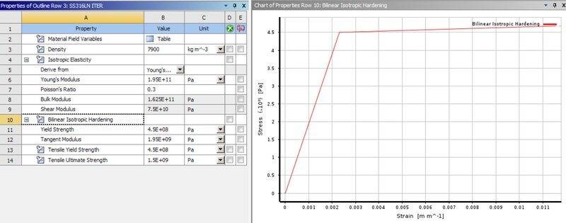

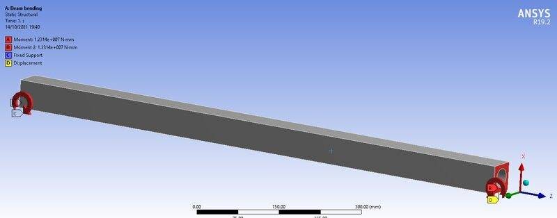

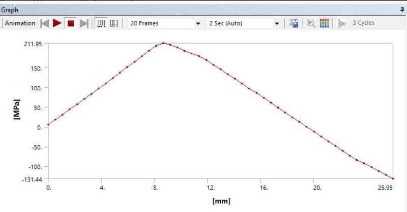

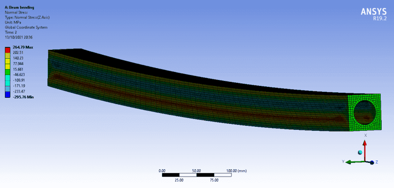

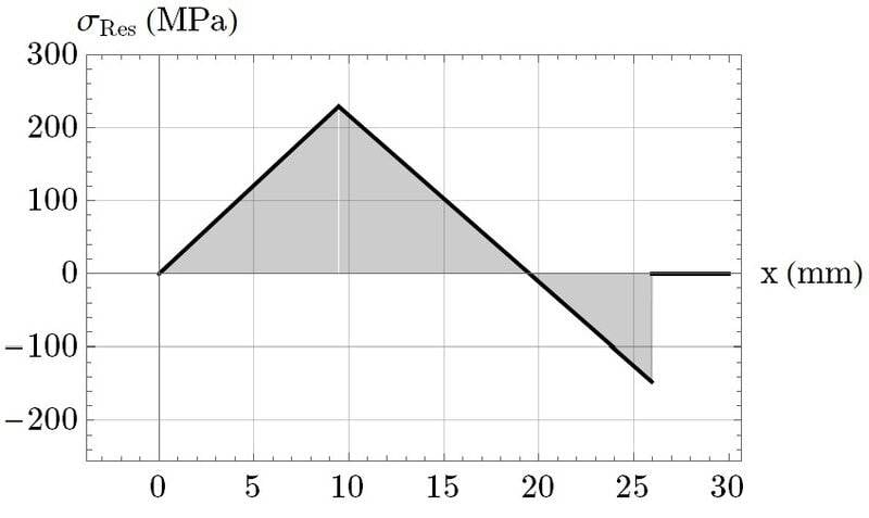

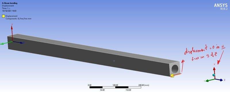

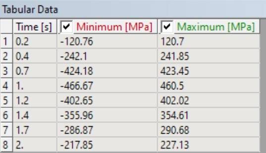

Hello everyone,
I have finally modeled a bilinear elasto-plastic bending phenomena in ANSYS in order to cross-check my analytical calculation.
By applying the bending moment I defined in the post above on a straight beam, and taking also all the mechanical and geometric properties I have defined in the previous post, I can say that the FEM values match very well the theoretical ones!
From the analytical model, the residual stress profile across the cross-section of the beam is the following:
From the ANSYS model, after applying the bending moment, the beam gets indeed bent, and after springback, I got the following shape and normal stress distribution in the zz direction:
The cross-sectional residual stress distribution (in the middle of the beam) is:
Then, finally, plotting the residual stress profile across a path of this cross-section I get:
Which matches very well with the first plot I have inserted here!
Also, the max stress before removing the bending moment, matches very well the calculation. I got ##\sigma_max = 457.8\mbox{ MPa}##, and from ANSYS, during the bending process we see that the max value is similar:

Here are some images with the setup in ANSYS:
Material properties list:
Overall setup of the beam with the bending moment of 12.314kNm applied on both ends:
Fixed edge on one end:
Fixed displacement in xx on the other edge:
freddie_mclair said:
Thanks guys for your reply, but I'm looking for an analytical solution. The first thing I did was to compute what is the necessary bending moment, ##M_b## to get the radius I need, ##R_k## by computing the integral in Mathematica.
Then, with ##M_b## I can also get the stress profile in the cross-section by using ##\sigma_b = \frac{M_b}{J}x##.
But then, what do I have to subtract from ##\sigma_b## to get the residual stress after unloading?

TL;DR Summary: After being a beam is bent, due to the springback effect, the resulting bent radius is larger than the bending radius. How can I estimate the residual stress that remains in the beam after an elasto-plastic loading/bending?
The strain, ##\varepsilon_L(x)##, can be defined as:
And the stress, ##\sigma_L(x)##, developed in the beam due to the loading by bending is:
##\sigma_L(x) = \begin{cases}
\frac{x}{R_0} \cdot E \mbox{, if } x \leq \varepsilon_y \cdot R_0\\
\sigma_L(x) = S_y+(\frac{x}{R_0}-\varepsilon_y)\cdot E_1\mbox{, if } x \gt \varepsilon_y \cdot R_0
\end{cases}##
I also know that, due to the springback effect, the relationship between the bending radius ##R_0## and the resulting radius ##R_r## is given by:
##\frac{1}{R_0} - \frac{1}{R_r} = \frac{M_b}{EJ}##
Where ##M_b## is the bending moment and ##J## the moment of inertia (in this case ##J=\frac{h^4}{12}-\pi \frac{r^4}{4}##).
The bending moment can be estimated by:
\end{cases}##
Now, with all this at hand, how can I estimate the residual stress on the beam after bending, i.e., after unloading the beam?
Thanks in advance!
