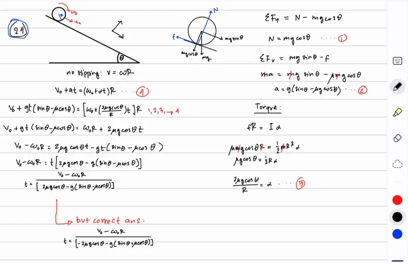

TL;DR: I may have some problems with sign of convention and stuff

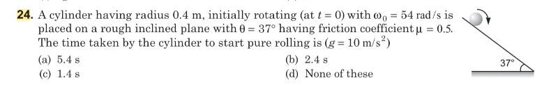

Physics problem 24: a cylinder of radius 0.4 m spinning at 54 rad/s is placed on a rough incline at 37 degrees, friction coefficient 0.5, g = 10 m/s^2; choices (a) 5.4 s (b) 2.4 s (c) 1.4 s (d) None of these. A sketch shows the cylinder on the slope.
Handwritten physics working on a rolling-with-slipping problem: a sphere on an incline with free-body diagram, force and torque equations, and a boxed corrected expression for t.
Attempt at solution and correct answer is attached. the linear acceleration indicates that the friction actually is in the same direction as linear speed.

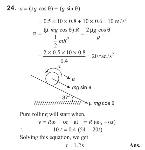

Handwritten solution to a rolling-on-incline problem: a = 10 m/s², alpha = 20 rad/s², with a diagram of a cylinder rolling down a 37 degree incline showing alpha, a, mg sin theta and friction mu mg cos theta.
Why is the angular acceleration anticlockwise here, against the direction of angular speed? Shouldn't angular speed increase? Please help

Please, note that the value of the final angular velocity is 20t=24 rad/s.
The dynamic friction of the rotating-sliding cylinder with the rough inclined plane consumed part of the original rotational energy.

The cylinder is initially spinning in a clockwise direction. The frictional force on the cylinder is down the incline. This provides a linear acceleration and a rotational deceleration.
so if I'm getting it right, it depends on the initial condition, right? if the cylinder at first only does translation, then the friction would be against the speed of center of mass, right?
Yes. In that case, there will be linear deceleration and rotational acceleration until the state of rolling without slipping is reached.

Yes, the direction of friction is opposite to the relative motion at the contact point. And that direction depends on: linear velocity of the center, angular velocity and radius.

For rolling-without slipping (RWS), the direction of the frictional force is always uphill. (You might want to think about why this is so!)
So for RWS uphill, the friction is in the same direction as the centre-of-mass velocity.
And for RWS downhill, the friction is in the opposite direction to the centre-of-mass velocity.

Just tried to answer your questions:
Because the rotation of the cylinder is slowing down with time.
It should, if its value at release time was zero, and friction was present.
In this case, the cylinder is said to be spinning at release time faster than it would if naturally rolling downhill.
What happened to that initial rotational energy?
