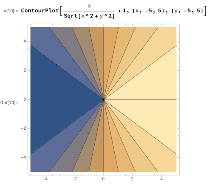

and the plot for contour lines looks like this:
Mathematica ContourPlot of x/sqrt(x^2+y^2)+1 over x and y from -5 to 5, showing radial straight-line contours fanning out from the origin, shaded in bands from dark blue on the left to pale yellow on the right.
##\textbf{Task e}##
I then solved the equation ##h(r)=H## for y as follows ##y(H,x)= \sqrt{\frac{x^2}{(H-1)^2}-x^2}## The shape of the contour lines in the first square are all straight lines
I could only see that they are straight lines from the contour lines plot and not from the equation above, did I calculate y(H,x) incorrectly?

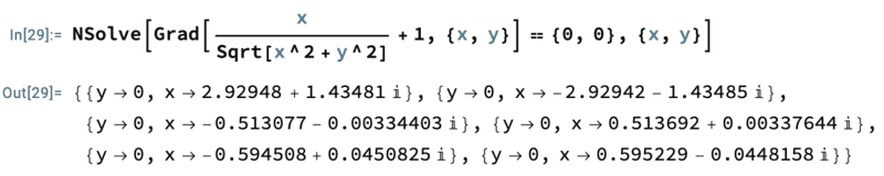

For the steepest and flattest slope, I have to insert the points into the above equation where the gradient is zero, so ##\nabla h(r)= \left(\begin{array}{c} 0 \\ 0 \\ \end{array}\right)## I have calculated these points with mathematica and if I have not made a mistake, unfortunately only complex solutions come out
Mathematica input In[29] NSolve[Grad[x/Sqrt[x^2+y^2]+1, {x,y}] == {0,0}, {x,y}] and output listing complex solutions with y → 0 and x values such as 2.92948 + 1.43481 i and 0.595229 - 0.0448158 i.
Have I made a mistake in calculating the steepest or flattest ascent or can I only do this with ##|| \nabla h(r) ||##?
In polar coordinates [itex]x = r \cos \theta, y = r \sin \theta[/itex] for [itex]-\pi \leq \theta < \pi[/itex] we have [tex]h(r, \theta) = 1 + \cos \theta.[/tex] It follows that [tex]\nabla h = -\frac{\sin \theta}{r}\mathbf{e}_\theta = - \frac{y}{r^2}(-y/r, x/r)^T[/tex] and [tex]\|\nabla h\| = \frac{|\sin \theta|}{r} = \frac{|y|}{x^2 + y^2}.[/tex] This is zero whenever [itex]y = 0[/itex] (and is undefined at the origin).
I suspect the fact that [itex]\nabla h[/itex] has degenerate (ie, non-isolated) zeros is confusing whatever algorithm Mathematica is using to solve [itex]\nabla h = 0[/itex]. Think before you compute!
