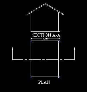

IS it possible to design a sloping roof (as shown in fig)?
if yes please help in placing of beams.]

Yes, but the weight of the sloping roof will cause a tendency to spread outwards, pushing out on the walls.
Two ways to counteract this outward thrust are to make the joints at the roof and walls truly rigid.
This is called a portal frame.
Another way is to place a tie across the two sloping sections of roof.

WILL the tie be sloping or horizontal (column to column)
Portal frames are the type you see in modern steel framed buildings, where you can see the steelskeleton from the inside.
Ties normally go across horizontally.
They are usually just above the top of the wall, where they are most efficient. Sometimes they can be further up, to about halfway up the rise of the roof. They are often combined with the ceiling support.
will the ties go in both direction or just along the walls where slab rest?
The ties go across from wall to wall, not along the walls.
How else could they tie the walls, or rafters together?
No, I'm sorry I'm not at home, or even in my home country so I cannot draw it for you.
The ties must connect opposite walls near the top or opposite rafters near the bottom. Ties can be much thinner than beams.
The upper left hand drawing is fine. and would provide support for a conventional ceiling.
The upper right hand position is OK, but a V shaped tie is not. A light horizontal member at this location would also work.

sorry but v shape is not a tie but just a arrow pointing towards the sloping ties under the roof (forgot to make it red)
sorry for being careless
so both fig are correct
i think right one will suit my needs
PLEASE CONFIRM
The horizontal element you have labelled tie in the top left hand drawing is a fine tie.
It is in the plane of the section drawing and pulls the tops to the two wall towards each other.
There is no tie shown in the top right hand drawing, so this is not OK. I repeat elements at right angles to the drawing cannot be ties. You should redraw the sloping section of the roof so it looks like the letter A.

so ties should be horizontal and cannot be sloping.and what about their spacing and dimensions in general.something like 23 cm* 30cm in cross section with a spacing of 3 to metres (column to column)
can i use make it a ribbed slab(sloping beams under slab) so there is no need for ties?

I'm slightly concerned about the fact you don't seem to understand the basics of roof design and yet you're trying to do it. Potentially catastrophic to your home at best.
You need cross members. If you look at roof design on any new houses you will see the characteristic A shape. It's there for a reason.
