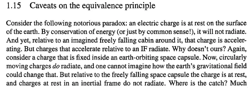

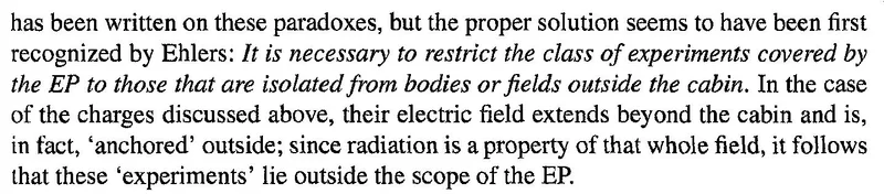

According to Wolfgang Rindler, the EP cannot be applied to the "paradox" of an accerated charge, because it's field is not local. An electric charge at rest on the surface of the earth does not radiate by energy conservation.
A charge, fixed inside an orbiting satellite, does radiate.
Source (Relativity: Special, General, and Cosmological, 2nd edition, chapter 1.15):
https://www.amazon.com/Relativity-S...fgang-Rindler/dp/0198567324?tag=pfamazon01-20
Printed book page titled '1.15 Caveats on the equivalence principle', with a paragraph on a charge at rest on Earth's surface versus a charge in an orbiting space capsule.
Printed book page excerpt quoting Ehlers: restricting the equivalence principle to experiments isolated from bodies or fields outside the cabin, with the charge's field anchored outside.
