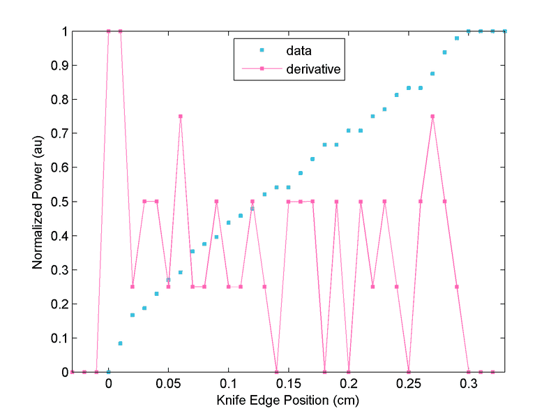

What if we use Matlab's smooth(.) function with a span 3 moving average filter? This would also be a 3-point smoothing algorithm except we have the same number of data points as we started. Is this method more or less accurate than combining the points?
Here is what I got (smoothed = magenta, original derivative = brown):
Line plot of normalized power (au) against knife edge position (cm), with two dashed series: a yellow square-marker curve and a magenta dot-marker curve, both rising to a peak near 0.01 cm, fluctuating between 0 and about 0.75, and falling to zero near 0.31 cm.
I need to reconstruct the actual beam profile as accurately as possible.

By more aggressive do you mean taking a larger span? I mean, instead of averaging 3 points, you could average a larger number of points.
How would you decide what is a good place to stop smoothing? I've noted that beyond a certain point (in my case, ##\text{span}=33##), you will not see any additional changes to the plot.
For example, yes. You can also average over points with different weights for them (larger weights for points nearby).

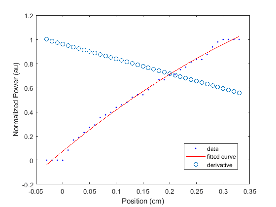

So, the idea is to use symbolic differentiation to avoid the noise problem in the numerical computation?
As you suggested, I did fit the data using polynomials of different degree, and here are the first few R2 values:
\begin{array}{c|ccccc}
\hline \text{degree} & 1 & 2 & 3 & 4 & 5\\
\hline R^{2} & 0.9885 & 0.9941 & 0.9945 & 0.9945 & 0.9969
\\\hline \end{array}
I went up to degree 9 and R2 kept increasing. But that might be because we are just modeling the noise in the data at that point.
For the quadratic for instance, you have an equation of the form ##ax^2 + bx + c## which has the analytic derivative ##2ax+b##. But when I plot it, I get this which doesn't look anything like the beam profile:
Scatter plot of normalized power (au) against position (cm) with blue data points, a red fitted curve, and blue circles showing the derivative; data rises from about 0 to 1, derivative falls from about 1 to 0.56.
What is wrong here? :confused:

roam said:
What is wrong here?
Basically nothing. You fit a parabola, you get a parabola. What you want to fit is ideally an almost square block with a lot of detail (*). Try to see what kind of integrated function that would yield.
(*) Detail that is not present in your data: steep edges, with possibly some small deviations on the flat part.
In short: you need higher resolution in both directions: less coarsely rounded off data points an a lot more of them

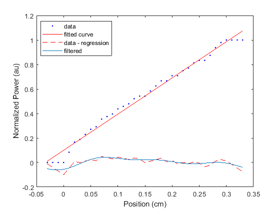

The linear regression shows a very high value for r2, so use that for a basic approximation.
Now I (being curious) would subtract the linear regression values from your data and do an FFT on the differences. The lower frequencies of the transformed data might tell you something (try throwing away everything but the three lowest frequencies and transform that back).
Hi Svein,
So what is the idea behind subtracting the regression from the data? And are we discarding the high frequencies as being noise?
I did what you suggested. In the DFT, I only kept the 3 lowest terms next to the DC term. Here are the results:
Plot of normalized power (au) against position (cm): blue dots of data rise roughly linearly from 0 to about 1, with a red fitted straight line through them; below, a red dashed residual curve and a blue filtered curve hover near zero, with small wiggles.
How can we use this information to reconstruct the beam profile?
Well, you know much more about the experiment than I do. What I was looking for in the DFT was some regularity in the deviations from the straight line, but there does not seem to be any. My conclusion would be that the linear regression is a very good fit to your experimental data (an r2 of 0.9885 - there are sciences where an r2 of 0.1 is considered exceptionally good) and the deviations are due to noise/measurement accuracy.
I agree. I think that the deltas for the derivatives being such a small set of fixed values shows that the measurement accuracy is a limiting factor and will not allow better results.
During my measurements, the increase in data points appeared to occur at fixed increments (that's how I recorded the data). That was the best I could do with my measuring instrument – it wasn't possible to record the values precisely (i.e. using longer decimal format). So, is this what causes the discreteness of the derivative values?
Any explanation would be appreciated.
It certainly appears that way.
To keep things simple, suppose one is measuring values between -1.5 and +1.5 but the recorded values are always rounded to the nearest integer -1, 0, +1.
There are only the following 9 cases of (rounded value of ##y_{i+1}##, rounded value of ##y_i##): $$(-1,+1), (-1,0), (-1,-1), (0,+1), (0,0), (0,-1), (+1,+1), (+1,0), (+1,-1).$$ They give the 5 cases for ##y_{i+1} - y_i##: -2, -1, 0, +1, +2.
It appears that these 5 cases correspond to the 5 values that you are getting (except that your Y values trend upward so the deltas are always nonnegative). So it looks like the recorded values are always rounded to values that do not allow very much resolution for the derivative. Any detailed conclusions you reach by analysing the derivative may be saying more about your rounding process than about the derivative itself.

Also: if I obtain high precision data and want to use symbolic computation, would differentiating a quadratic polynomial work? It clearly didn't work using the current data (my post #11)...
@Mark Harder I could send you my data if it helps, but as others suggested I think it is better to obtain more precise data first. I am using high energy lasers so using current modulation I should be able to lower the power and use a very sensitive meter.
@Telemachus Sure thing. Since this thread is under a mathematics forum, I will message you the details of the physics of the setup.
Roam, I forgot to mention that I was assuming in my analysis that the x-intervals in your measurements were all equal. If the intervals between points vary across the data, then the problem is more like an interpolation.
