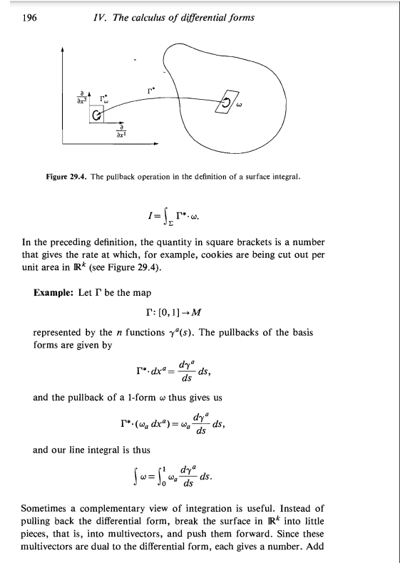

People have defined differential forms as "the things you integrate", so don't be alarmed. I've attached an example from a book called "Applied Differential Geometry" by William Burke that might help make sense of why it works.
Diagram of a pullback operation: a curve Gamma runs from a small square patch in the x1-x2 coordinate plane up into a larger closed region in R^k, with the form omega shown at the endpoint, labelled Gamma* omega.
