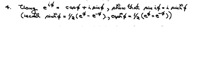

I need to show that sin i*theta= i* sinh(theta).
where sinh(theta) = .5[e^theta - e^(-theta)]
and cos(theta) = .5[e^theta + e^(-theta)]
and e^(i*theta) = cos(theta) + isin(theta)
if I start with the formula sinh(theta) = .5[e^theta - e^(-theta)]
and plug in e^(i*theta) = cos(theta) + isin(theta)

Are you sure it isnt..
[tex]sinh(i \theta) = isin\theta[/tex]??
nope..
sin(i*theta) = i*sinh(theta)
Attached is the question as given by the professor

This isn't true. Try finding [itex]\sin(i\theta)[/itex] first with Euler's formula, and then compare the result to what you were given for [itex]\sinh(\theta)[/itex].

Alright, I'm going to show you a little bit of wizardry. We know that
[tex]e^{i\theta}=\cos(\theta) + i \sin(\theta) \; \; \; [1][/tex]
Now let [itex]\theta = -\theta[/itex] so that:
[tex]e^{i(-\theta)}=\cos(-\theta) + i \sin(-\theta)[/tex]
Using the facts that cosine is even and sine is odd (which you already knew):
[tex]e^{i(-\theta)}=\cos(\theta) - i \sin(\theta) \; \; \; [2][/tex]
What happens if you subtract [2] from [1]?

You've determined that [itex]\sin(\theta)=\frac{1}{2i}(e^{i\theta}-e^{i\theta})[/itex]. Here is where you should sub in [itex]\theta = i\theta[/itex].

You should be subbing in [itex]i\theta[/itex] into [itex]\sin(\theta)=\frac{1}{2i}(e^{i\theta} - e^{i(-\theta)})[/itex]. In other words, simplify the following:
[tex]\sin(i\theta)=\frac{1}{2i}(e^{i(i\theta)} - e^{i(-i\theta)})[/tex]
And then compare it to the definition of [itex]\sinh(\theta)[/itex] in terms of exponential functions (given in the question.)
