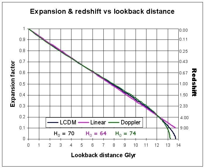

I'm not aware of an 'accepted function' compatible with current observations, other than integrating for comoving distance or lookback distance using the LCDM model. Before accelerating expansion has been observed, it was relatively easy to obtain a function, but not any more, I think...
That said, it is interesting to note that a linear function can be fitted reasonably well to the standard expansion factor vs. lookback distance curve, up to around 12 billion years light travel time:
[tex]a = \frac{1}{z+1} = 1-\frac{r H_0}{ c}[/tex] , where r is lookback distance.
I attach a graph showing 'best-fit' values of this linear function and also the Doppler shift function (of the prior posts) to the standard LCDM curve, with H_0 as shown.
