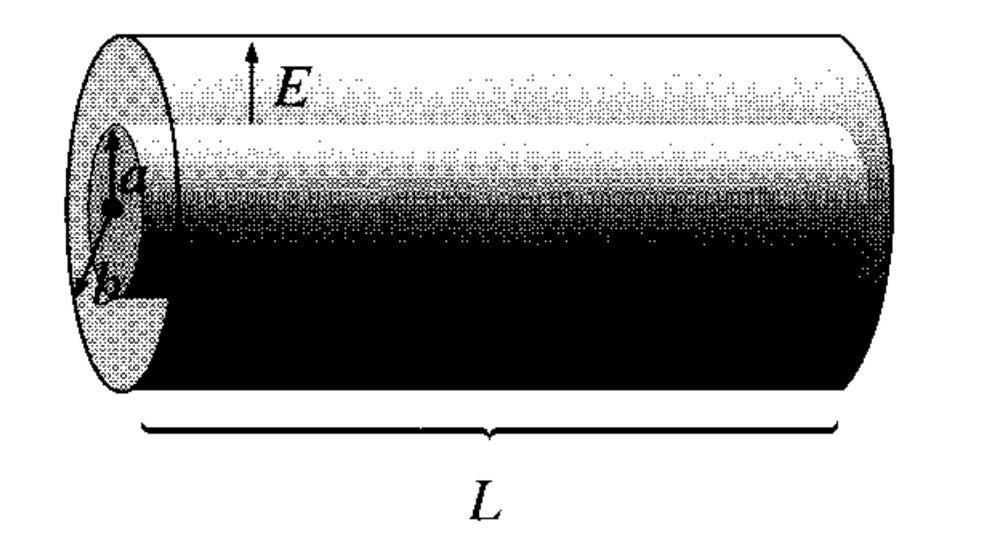

My idea is that we're dealing with two coaxial cylinders,separated by material of conductivity ##\sigma##. The current is flowing along the axis, and there's an electric filed pointing radially outwards.
Isn't this the scenario?
No, I don't see how you can read it that way. It says the conductivity varies continuously with radius. If there were a radial field then there would be radial current, but it says the current is along the cylinder.
