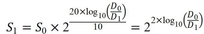

tech99 said:
I believe that Alexander Graham Bell found that a sound appears half as loud when it is one tenth the power. This is one Bel or 10 decibels. So a 10dB reduction will sound half as loud.
By increasing the distance about three times, the aeroplane will sound half as loud.

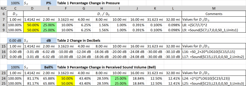

I have fixed my table. It now looks like this:

  • #35
This gets to my second point above to Sophie. Are you saying (or are you saying that Bell said or observed) that while doubling the distance reduces the power to 25%, not only is that not perceived as 25% as loud by people, but it has to get down to 10%, which means increasing the distance by a factor of ~3.16 (10^.5)?
  • #36
This is interesting. Yesterday, I came up with this equation that calculates the perceived sound as a function of distance.
It appears to work as illustrated by this table, which calculates the percentage of the perceived sound at D0 that is perceived at D1:
The distance at H23 is sqrt(10) and the percentge is, at predicted, 50%. The distance at L23 is 10 and the percentage is, as predicted, 25%.
But I can't remember how I got to that formula.
Can you tell me if it is correct and, if so, the derivation?
Thanks
PS: That table only shows the distance in one dimension. I didn't want to burden any of you with my "voluminous" tables. :smile:
