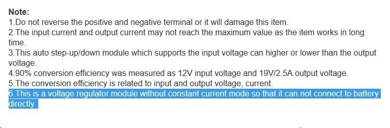

I am using this dc-dc boost converter: link.
I do not really care much about the output amp value. Only the output voltage has to be at least 13.5 for the boost converter to charge the battery. Unfortunately it doesn't last long and it will return to the open circuit voltage of the solar panel after 10-15 seconds. The booster also makes some ticking noises before the voltage drops to solar panel voltage.
Your description of shutting down is almost always due to overload, current or thermal overload in this case. That particular model seems to be discontinued. Check this site to see if another model will fill your needs. Link. And pay attention to the warning about its usage!

Battery may be drawing more than the rated current. Check with an ammeter. Also what type of battery - I assume lead acid.
What is the voltage of the 12V battery before connecting it to the solar panel?
As TomG and anorlunda have hinted it might be a problem of application.
What controls output current to the battery ? How much do you measure going to the battery ? Did you notice this caution in the directions at link you posted ?

Then insert your converter between the solar panel and battery and let it step 18 volts down to 13.5
In bright sun it should operate as step down and in weak sun it should act as step up,
and if i have read that datasheet correctly it'll auto-select whichever it needs.
With a little bit of luck the inherent current limiting nature of your solar panel will cure the trouble.
If not you might have to employ a current limiter.
