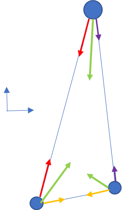

Each planetary body attracts each planetary body in the system. The directions of the forces on each body at each instant have consequences for the net force each body experiences at an instant. So, the acceleration of a particular body is not just the sum of the magnitudes. Are you accounting for both magnitude and direction of net force acting on each body at each instant, or just magnitude to find the acceleration of a particular body?

Parziter said:
Hey ! I'm not sure of what is your question, but I understand well, you're asking me if I'm multiplying the magnitude by the vector from A to B, A the body attracted and B the attractor, right ? If so, yeah I'm doing that, and re calculating all the forces at each instant.
I was just saying the green vectors are representative of the net forces acting on a particular body from the other bodies at a particular instant.
Oh yeah I'm doing it, green arrows are the sum of the two other arrows right ?
Yeah, added vectorially.

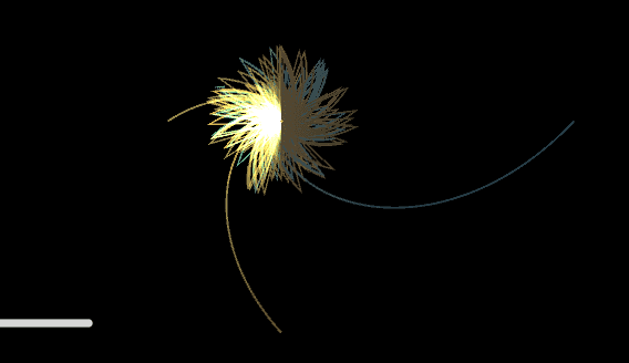

Parziter said:
Uhh not sure to understand the question I'm sorry... But my Sun is moving in space, because it is attracted byt all planets, so it's slow but yeah, it's moving, if that was the question.
I wonder how having all the precise initial conditions will come into play. I believe n-body systems can exhibit chaotic behavior if things are a bit off. Does anyone know what happens if they start the simulation and all the initially conditions are a bit off from their "true" values for a particular initial configuration?
Well, with my actual program, all the planets are well rotating. Then, if I for exemple change the mass of one planet, it will change everything and all other planets will be attracted by the most massive one.
Here is an old exemple of when my velocity's function was wrong, so the planets were too slow, so there were attracted by the sun.
