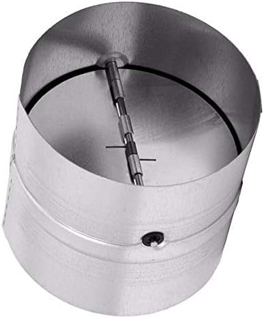

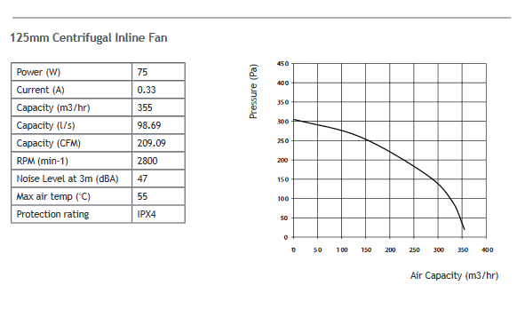

Good day all,
I am currently building a fume hood for a soldering station which will exhaust air to the outside world via filtration.
As I would like to maintain constant negative pressure inside the hood, even in the event of back-draft from outside due to inclement weather, or one too many air entry/exits in the building momentarily open, I am after some ideas on how I would implement an air pressure sensor within the fume hood to measure and/or alert when back-draft is present.
At a guess, I figure I would need a pressure sensor inside the hood and one outside the hood to measure the relative pressure difference.
My question is;
Would a 10kPa air pressure sensor both inside and out of the fume hood (inside the building) register the pressure difference for the specifications of this fan? I am trying to conceptualize the fact that the interior sensor will measure fan influenced air pressure and the exterior will simply be measuring atmospheric pressure.
Would something like this work?
https://www.mouser.com/ProductDetail/NXP-Semiconductors/MPX5010DP/?qs=N2XN0KY4UWXY1XQyQ71Xsg==Many thanks for a push in the right direction
