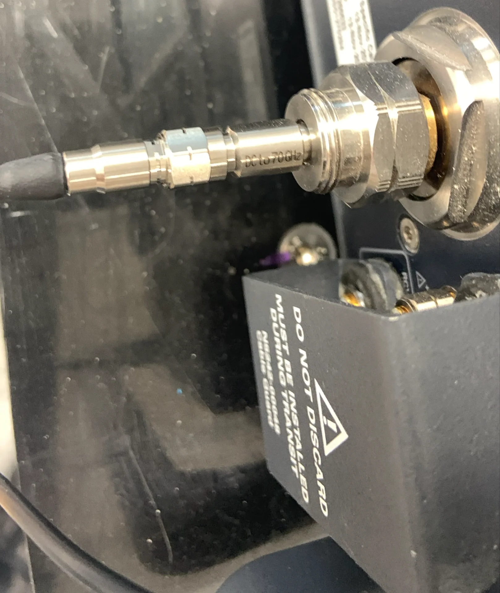

Hello,I have a PNA which works till 120GHz I use a 1mm to 1.85mm adapter to measure till 67GHz 1.85 SMA.
I need to measure a differential lines.
At first i got low causality about 50% so i played with the connector screwed unscrewed tried wipe of some spots i saw on the ground pad.
Then i saw that the causality got to almost zero and i cant improve it back to the values before.
I tried to changes cables to shorter ones.
I dont know if my 1mm to 1.85mm screwed proprly to the PNA.
I dont know how to place propectry the SMA and how much presure to put on the screws so it will work properly.
Any help?
photos attached.
Thanks.

Its end launch 1.85 connector.
I have wera 851/9C 1 PHO which is Ncm, 8in-lb is 11Ncm.If i put 11 its too hard on the connector I feel.
Is there a way In the VNA to see if the connector is propely connected?

Use TDR mode to look at the internal impedance of connectors.

Your PNA instrument has 1.0mm connectors, good from DC to 120GHz.
You adapt the 1.0mm to 1.85mm which is then good only to 70GHz.
You do NOT use SMA (≤18GHz), which is quite different from the 1.85mm system. The 1.85mm and SMA look very similar, but have different dimensions and threads, so they cannot be reliably mated.
If you use the wrong connector you may deform the mate, so it will not contact correctly again without correction or replacement. As an example: If you use a 50Ω BNC male to connect to a 75Ω BNC socket, it will seem to work with only a 50:75 impedance mismatch, but the socket may be physically spread, sufficiently to make unreliable contact with a 75Ω BNC male in the future.
The connector image you show in post #1, looks like a "vertical launch" connector, that has an angle of 90° between the trace and the connector axis. It is not an "end launch" connector, one that mounts on the edge of the PCB keeping the connector axis in line with the trace on the PCB. The 90° bend may restrict the bandwidth. Or maybe that is the SMA you refer to, that does not mate with a 1.85mm connector?

Cleaning the contact face or examining for distortion could reveal any obvious problem. Also, changing the connector for a new one or, as I already commented, try a soldered version.
A thorough internet search (AI) for work on the problem of connection to a circuit board could be good value. You need to find someone who's actually had similar problems and solved them.
