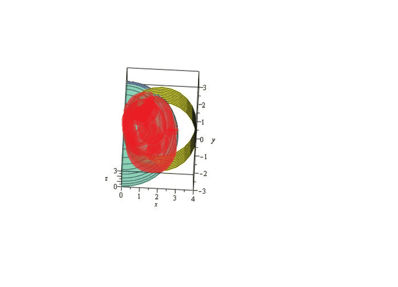

sorry , after looking it carefully ,the solid formed is the red part ? (refer to the attachment)
So , the red part represent the projection to xy plane ?
  • 3D plot in Maple-style rendering with axes x from 0 to 4, y from -3 to 3, and z from 0 to 3, showing a translucent red solid, a teal surface and a yellow curved surface.

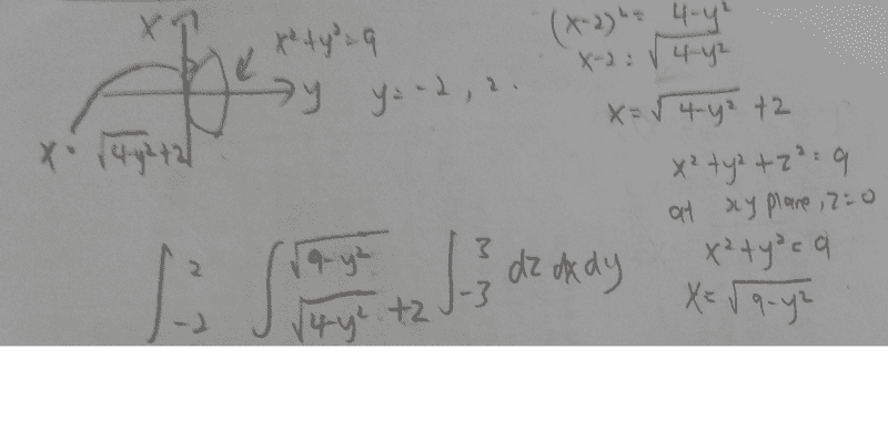

here's my latest working . I use xy plane projection

  • Handwritten triple integral setup on grey paper: integral from -2 to 2 dy, inner integral from sqrt(4-y^2)+2 to sqrt(9-y^2), then integral from -3 to 3 dz dx dy, with notes x^2+y^2+z^2=9, xy plane z=0, and x=sqrt(4-y^2)+2 and x=sqrt(9-y^2).
You have errors in your work. But you are supposed to do it in cylindrical coordinates anyway. You need ##dz,~dr,~d\theta## variables in your integrals.
