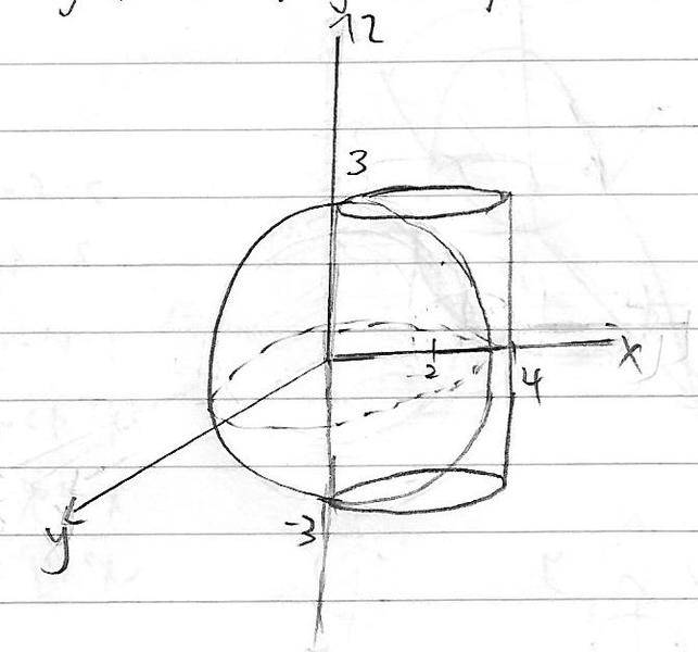

chetzread
798

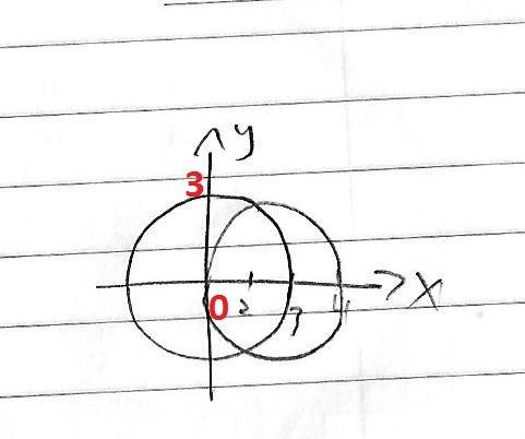

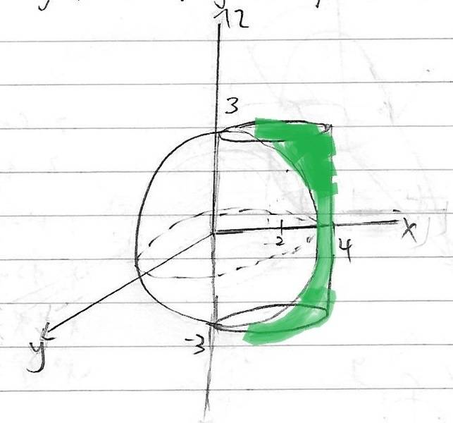

By using cylindrical coordinates , evaluate the volume of solid bounded on top of sphere (x^2) + (y^2) + (z^2) = 9 and it's sides by (x^2) + (y^2) = 4x . [/B]
I have sketched out the diagram , but i dun know which part is the solid formed... Can someone highlight the solid formed ? [/B]

sorry , i made a typo . The original question is evaluate the volume of solid bounded on top by the sphere (x^2) + (y^2) + (z^2) = 9...
Here's after correction , the cylinder span from z = -3 to 3 ...
What is the portion of the solid bounded on top of sphere (x^2) + (y^2) + (z^2) = 9 and it's sides by (x^2) + (y^2) = 4x ?
I couldn't imagine

chetzread said:
or there's something wrong with my diagram ?
Neither of your diagrams is very helpful, and both are incorrect. You have the circular cylinder located in the wrong place in both diagrams, and your drawing of the sphere just looks like a circle. Here's a quick sketch I did that attempts to show the portion of a sphere in the first octant.

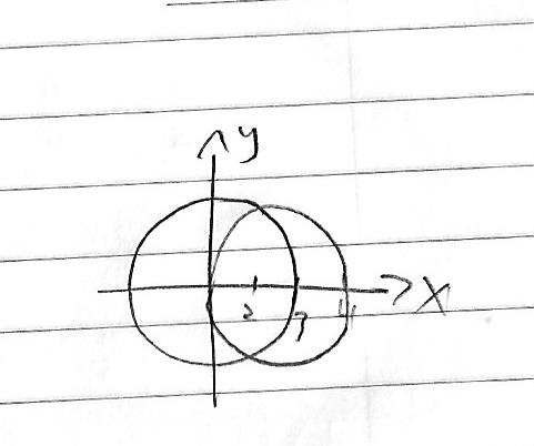

@chetzread: In the ##xy## plane, draw the two circles ##x^2+y^2 = 9## (which is where the sphere cuts the ##xy## plane) and ##x^2+y^2 = 4x## (after you get it right). That picture should help you figure out the ##xy## region that your cylindrical coordinate ##r,\theta## region needs to describe. Hopefully you will see that you need two different integrals to set it up.

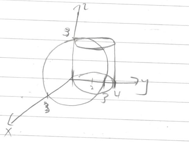

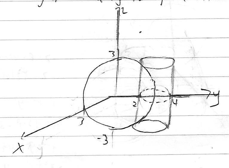

@Mark44 , @LCKurtz , is my cylinder located at the wrong position ?
So , i have chnaged the location ... Pls refer to the latest diagram i uploaded here
Here's what i did :
##x^2+y^2 = 4x##
##x^2-4x+y^2 = 0##
##(x-2)^2 -4 +y^2 =0##
##x^2-4x+4-4+y^2 =0##
##x^2+y^2=4x##
So , the circular part of cylinder located at x =2 , right ?

LCKurtz said:

The central axis of the cylinder goes through (2, 0, 0), yes, and is vertical. Your diagram is close to correct, except the sphere is slightly too large.
Ok, my problem now is which is the region that the solid formed? Can you sketch the part that the solid form using my diagram? I have problem visualizing it...

Draw a 2-D sketch of the projections of the two objects in the x-y plane.
do you mean the green part is the solid formed ?

here it is ...
About time to hit the sack here. Where is the origin ##x=0## and ##x=1## on your sketch? Get it correct, then we can continue tomorrow.

here it is x = 0 ...

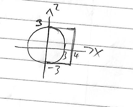

Now, how about another two-dim. sketch, this time looking at the x-z plane?
here

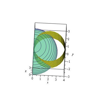

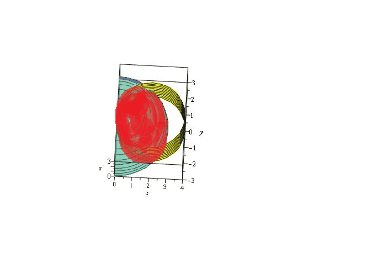

In order to facilitate getting this thread finished I am including a picture:
This is looking almost straight down the z axis. You can see that the portion of the sphere inside the cylinder lies above the region which I will call ##D## which is the intersection of the two circles in the xy plane. So if you want the volume under the sphere and above the xy plane you have to set up the integral for the volume under the sphere over the region ##D## in polar coordinates. If you want to include the volume under the xy plane you would double that. That is what this problem is really about -- setting up that integral properly.

sorry , i really have problem understanding your diagram , can you explain further ? do you mean it's the view looking down from z a-xis ? if so , then i still can't understand it
do you mean green part = sphere (x^2) + (y^2) + (z^2) = 9 ?
yellow part = (x^2) + (y^2) = 4x ??
But , why isn't the (x^2) + (y^2) = 4x closed ? it's a cylinder , right ?

OK , but how do the solid formed look like ? I have problem of visualizing it . . . . . Can you sketch a separate diagram for the solid formed ?

Yes, the green part is the upper half of the sphere,
It's a circular cylinder - the view, as LCKurtz said, is almost straight down the z-axis. The upper and lower ends of the cylinder are open, so I'm not sure what you're saying.
