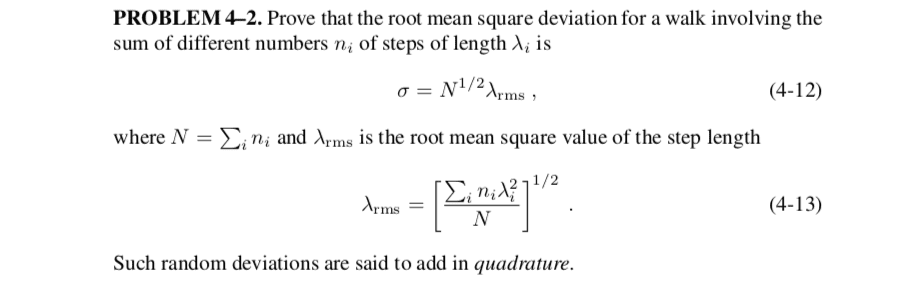

Prove that the root mean square deviation for a walk involving the sum of different numbers n of steps of length λ
random walk
246472
I don't have any idea to prove this 😢
##n_i##is number of trial, right?
##n_i## is the number of steps in the ith trial
I got it.
So,I think (4-12)means ##σ=Σ_in_iλ_i^2##, but I don't understand what is this 😢
arcTomato said:
I got it.
You need to start from the other end.
You have a random walk in which n1 steps are of length λ1, n2 steps are of length λ2, and so on. I presume you are to take these as all being in the same straight line.
At the end of this walk you are at distance X from where you started. Can you write an expression for σ, the root mean square of X?
uhh, I don't know how.
##σ^2=<X^2>=<(n_1λ_1+n_2λ_2+,,,,,n_iλ_i)^2>=<(n_1λ_1)^2>+<(n_2λ_2)^2>+,,,,,,##
like this??
like this??

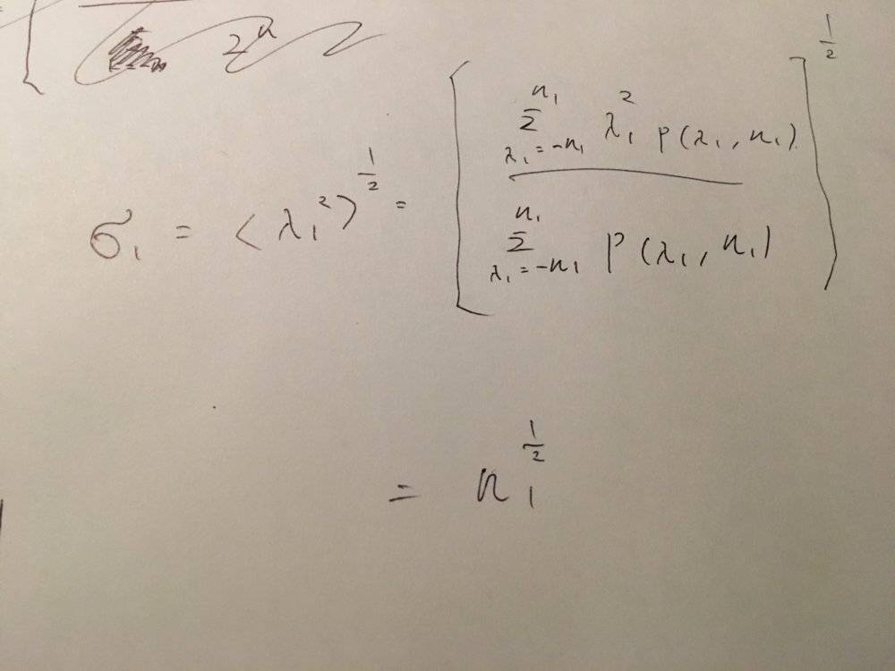

No, you need some probabilities in there. Each step can be either way.
probabilities??like this??
