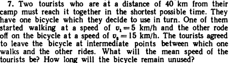

Two tourists who are at a distance of 40 km from their camp must reach it together in the shortest possible time. They have one bicycle which they decide to use in turn. One of them started walking at a speed of ##v_1 = 5\,\text{km/h}## and the other rode off on the bicycle at a speed of ##v_2 = 15\,\text{km/h}##. The tourists agreed to leave the bicycle at intermediate points between which one walks and the other rides.
(1) What will the mean speed of the tourists be?
(2) How long will the bicycle remain unused?

Problem : I copy and paste the problem as it appeared in the text.
Attempt : ##\texttt{I could make no significant attempt at solving the problem.}##
The only thing I realise is that if the two tourists be A and B, A travels on the bicycle for a while, leaves the bicycle and walks. B catches up with the bicycle and overtakes A who is on foot and stops at a distance further, leaving the bicycle and continues to walk. A catches up with the bicycle and cycles on. This continues till they both reach the camp at the same time.
However, every trial I made (manually), A and B don't arrive at the camp at the same time.
Or going backwards, taking arrival at the camp to be simultaneous, when I trace back, giving them times on and off the bicycle, they don't start off together.
##\texttt{How to decide how much time they spend on foot and how much time on the bicycle?}##
Request : Any help or hint would be welcome.

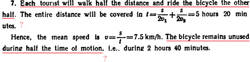

The book solutions show that these answers are right.
Doubts :
(1) ##\color{red}{\huge{*}}##Before I solve the problem using space-time diagrams, I confess that I haven't understood the argument for equal distances covered by a given tourist on cycle and walk for minimal time of travel [##x_C = x_W##], which I have marked with a red asterisk. The authors make use of the same point, which I underlined in red (##\color{red}{\rule[0.4pt]{20pt}{1pt}}##).
(2) My derivation of the idle time of the bicycle was long and arduous. The authors do it quickly, claiming that the bicycle remains idle for half the time of total travel, but how? I have underlined in red (##\color{red}{\rule[0.4pt]{20pt}{1pt}}##) the author's statement in the solutions above.
Request : An explanation for the above doubts.

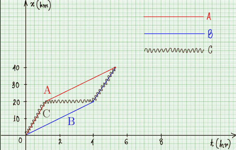

I have drawn the distance time graph of the problem below for tourists A and B, and the cycle C. But it hasn't helped me in my solution of the problem. In fact, having solved the problem analytically, I used the values to draw the graph.
Crucially, I don't see why the distances travelled by each tourist on cycle and foot should be the same.

The bicycle covers the whole distance, never reversing, so at any point on the road one must walk there and the other cycles there. So the distance one walks is the distance the other cycles.
If the time for both to have arrived is minimum, can you see that means they arrive at the same time?

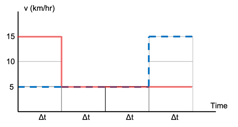

A velocity vs. time graph provides an at-a-glance solution and summarizes the points made above.
The initial biker gets drops the bike off at time ##\Delta t## (to be determined) and continues on foot. His velocity is represented by the solid red line below. The initial walker needs time ##3\Delta t## to get to the bike and reaches the end after an additional ##\Delta t##. His velocity is represented by the dashed blue line.
Consider a unit of displacement represented by the area of a rectangle ##\Delta x=5~(\text{km/hr})\times \Delta t.## Both tourists have covered the same distance ##6\Delta x## in the same amount of time ##4\Delta t##.
From the graph we see that
  1. The distance traveled by each tourist is ##~6\Delta x=40~\text{km}\implies \Delta x = 20/3~\text{km}.##
  2. The bike is dropped off at distance ##~3\Delta x=3\times (20/3~\text{km})=20~\text{km}~## from the starting point.
  3. The bike is dropped off at time ##t_d=\Delta t=\dfrac{\Delta x}{15~\text{km/hr}}=\dfrac{4}{3}~\text{hr}.##
  4. The bike remains idle for an interval ##(\Delta t)_{\text{idle}}=2\Delta t=\dfrac{8}{3}~\text{hr}.##
  5. The total time for the trip is ##T=4\Delta t=\dfrac{16}{3}~\text{hr}.##
  6. The average speed is ##v_{\text{avg.}}=\dfrac{40~\text{km}}{T}=\dfrac{40~\text{km}}{16/3~\text{hr}}=7.5~\text{km/hr}.##
