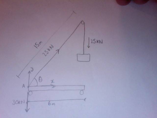

Hi, the problem states;
A crane of mass 30,000kg is secured to the end of a steel plate 6 m long. At each end of the plate are a set of wheels. The crane has a jib of length 15m and is required to lift a mass of 25,000kgs from the end of the jib. The jib is positioned over the 6m long steel plate.
Draw a free body diagram.
What is the minimum angle with the horizontal that the jib can be, without the crane falling over?
I've attempted the free body diagram (the forces need scaling up by 10), I'm pretty sure it's not correct, any pointers in the right direction would be appreciated.
Thanks

Is the load distributed evenly over the 2 sets of wheels i.e. 150kN over each?
I've indicted on the attached picture 250kN for the tension in the cable. Is this correct?
Certainly not.
And when the crane is about to tip over, the load on the real wheel will be zero, won't it? :wink:
The tension is an internal force, and has nothing to do with this problem.
You need only consider external forces. :smile:
erm :redface: … that isn't a free body diagram …
an fbd is a diagram with all the external forces marked on it (with arrows) at their points of application.
Draw an fbd for the crane-plus-wheels-plus-load considered as one body.

The external forces in this case are the weights (draw the arrow at the centre of mass of each part) and the reaction forces from the ground on the wheels.
The tension in the cable, and the reaction force between the jib and the plate, are internal forces.
(But when the crane is about to topple, it will do so over the front wheels, and so the reaction force on the back wheels will then be zero, so you can ignore that force.)

thanks tiny tim, a little clearer. I've redrawn the fbd. Is this correct?
nvn: I've taken g=10m/s^2 just for ease here.

Hi Wilko81! :smile:
Nope. :redface:
Your free body diagram should have three arrows …
i] for the weight of the jib, which (as nvn says) should be at the centre of mass of the jib (not the bottom where it joins the plate!)
ii] for the weight of the load (obviously, where the load is!)
iii] a vertical reaction force at the front wheel (you can ignore the back wheel because the diagram is for the when it's about to topple, and there will be no reaction force at the back wheel then)
we can assume the weight of the plate is negligible, since it's not given, but it's rigidly fixed to the jb, so the forces between them are internal (and equal and opposite anyway) and make no difference
ok, now take moments about a suitable point to find whether the angular acceleration is zero :smile:
