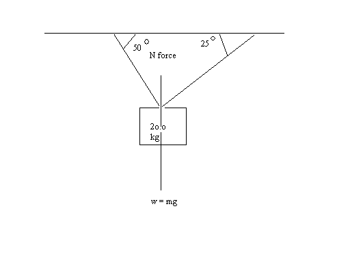

An object of mass 20.0 kg hangs suspended from a hook that is attached to two wires. The wires are attached to a horizontal cross bar and make angles with it that open up to 25 degrees and 50 degrees. What is the tension on each wire?
Here is the force body diagram as complete as I could make it. I do not know how to figure out what any of the other forces are.

start with components. The box is at equilibrium, so the sum of all the forces = 0 in each direction.
y comp = sin(theta)
x comp = cos(theta)
Well, its a little odd to put that normal force there in your problem. What you really have is just two tensile forces acting up along the axis of the two cables. So, 2 tensile forces, and erase that normal force.
There will be no normal force.
Now balance the forces in horizontal and vertical direction.
Suppose Tension is T1 in first wire and T2 in second wire
T1 cos(50) = T2 cos(25)
T1 sin(50) + T2 sin(25) = Mg
Now try to solve.
