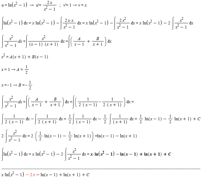

Thank you for your help, I understand my mistake.
I tried the way you suggested, and I got something very similar to the answer I look for, however one item is missing.
My solution is attached, my final answer is in bold. Underneath, in red, the real answer according to the book and maple.
I can't find my current mistake either...

Your mistake is in the partial fraction decomposition. It is not true that
$$ \frac{1}{2(x-1)}- \frac{1}{2(x+1)}= \frac{x^{2}}{(x-1)(x+1)}.$$
Just get the common denominator and check it out. Instead, you have
$$\frac{1}{2(x-1)}- \frac{1}{2(x+1)}= \frac{1}{(x-1)(x+1)}.$$
You have to perform polynomial long division first, as Chris mentioned, before you can do the partial fraction decomposition. Indeed, your equation $x^2=A(x+1)+B(x-1)$ should have clued you in that there was a problem: there are no $A$ and $B$ that can make the equation work, because on the LHS you have a quadratic, but no quadratic powers on the RHS.
