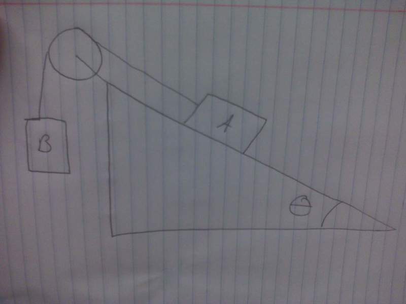

there are two blocks on a pully connected by a cable. one is on an incline and the other hangs in the air-see attatched photo. M1 = M2= 2.7kgs ; theta =34 ; coeffcient kinetic friction=.15 find acceleration
Fmax=N(coefficient kinetic friction)
Fnet=ma
i assumed block B was going down, wrote down three Fnet equations.Fnet1y=mgcos(theta)-mgcos(theta)=0 ; Fnet1x=T-mgcos(theta)(coefficient kinetic fr)=Ma ; F2=mg-T=Ma therefore T=mg-ma plugged it in the other equation and solved for acceleration. i got 4.3m/s^2 I am curious about solving for the force of friction... i thought it was N(coefficient static fr) in this case i have N=mgcos(theta) is this correct?

Can you write it out more clearly? It's difficult to check as it is.
(But I think you've left out the component of gravity along the slope.)
And yes, there's no acceleration perpendicular to the slope, so F = ma = 0 in that direction gives you N - mgcosθ = 0. :wink:
well my only real question is what is the force due to friction? is it µ*mgcos[tex]\theta[/tex] or µ*mgsin[tex]\theta[/tex]
or is this equation correct ∑Fx=T-mg(cosθ)µ this is the equation for the block on the incline
1)∑Fy=mgcosθ -mgcosθ=0
2)∑Fx=T-mg(cosθ)µ=ma
3)∑F=mg-T=ma
1&2 are for the block on the incline
It's µN, whatever that happens to be. :wink:
As I said before, you've left out the component of mg along the slope.
(not the friction force, the gravity itself, which would be there even if the slope was smooth)
oh are you telling me that gravity is acting dwn and to the rght? i think i see what u mean
It's what gravity does best! :wink:
