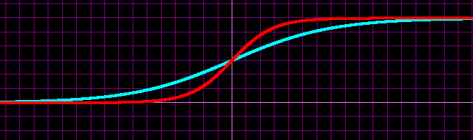

You're right. I didn't even think to plot the thing and see if the points fit. :wink:
After plotting it, I can see why the assumption that it is exponential for small values of x does not work in this problem. These points are near the inflection point.
Image (book = red, mine=blue):
http://www.orbitsimulator.com/BA/function.GIF
hmmm... This textbook usually doesn't make you think. All the problems follow the template of the example probems.
It looks linear near these points, but using y=mx+b gives me 1 for m and 3 for b. So I guess I can't assume this either.
