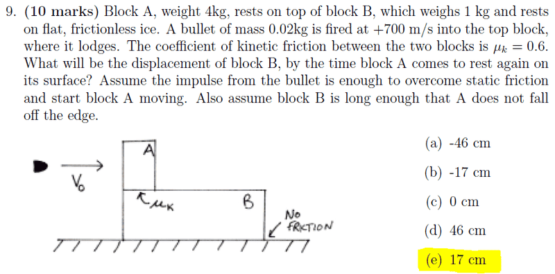

I don't know what I'm doing wrong, but I'm not getting the correct answer of 17cm ... :cry:
A will not stop. It comes to rest on the surface of B, that is they move together with the same velocity.

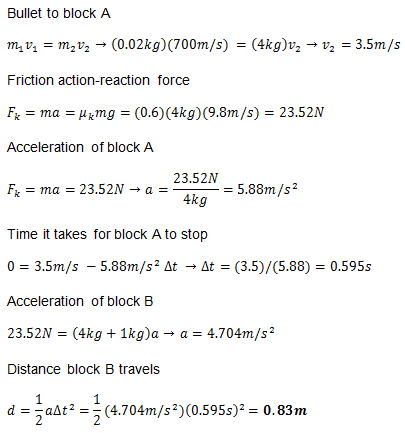

Does that imply that the time is wrong? Do I set up 2 equations, one for block A and block B and determine when their speeds will be the same?
Yes, the time is wrong. The force of friction decelerates A and accelerate B till their velocity becomes equal.
ehild
so...
3.5 - 5.88T = 4.704T
T = 0.331
d = (1/2)(4.704)(0.331)^2 = 0.257m --> still the wrong answer :(
You use wrong value for the acceleration of B. It should be the force of friction divided by 1 kg.
ehild
23.52N (the reaction force from the friction of block A) = ma
Now I assumed that it was the total mass of the system, since block A is on top of it and its moving with it. Was that assumption wrong?
23.52N = (m1 + m2)a
a = 23.52 / (m1+m2) = 23.52 / (4 +1 ) = 4.704m/s^2
Oh, okay I get the right answer now. But how come you don't use the total mass when finding the acceleration for B? It's directly on top of it ...

It is wrong. Zero external force acts on the whole system. The blocks interact, the force of friction is an internal force. A acts B and B acts A through the friction. So block B moves according to the force exerted on it by block A: F= 23.52 N.
ehild
OH ! okay, makes sense. Thanks :)
