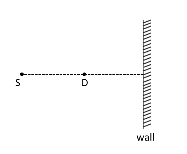

A source of sound S and a detector D are placed at some distance from one another. A big cradboard is placed near the detector and perpendicular to line SD as shown in figure. It is gradually moved away and it is found that the intensity changes from a maximum to a minimum as the board is moved through a distance of 20 cm. Find the frequency of the sound emitted. Velocity of sound in air is 336 m/s.
I have posted a similar problem in the past.
https://www.physicsforums.com/showthread.php?t=684072&highlight=sound+detector+wall
(The figure is present in the linked thread. I can't seem to attach it to the current thread :confused: )
I tried the current problem the following way:
Let the cardboard be initially at a distance ##x## from S and let D be at a distance ##y## from S. The path difference between the two waves reaching D is ##2(x-y)##. For a maximum, the path difference must be ##n\lambda## i.e ##2(x-y)=n\lambda\,\, (*)## where n is a non-negative integer. When the cardboard is moved by 20 cm, the path difference is ##2(x-y)-40##. For a minimum, this must be a equal to ##(m+1/2)\lambda## where m is a non-negative integer. Using (*), I get:
$$n\lambda-40=\left(m+\frac{1}{2}\right)\lambda$$
Solving for ##\lambda##
$$\lambda=\frac{40}{n-m-1/2}$$
If I assume ##n=1## and ##m=0##, I get the given answer i.e 420 Hz but if I assume some other values, I get different answers. :confused:
Any help is appreciated. Thanks!
The key thing is that the path difference between a consecutive maxima and minima is λ/2 .
Now when the detector is moved 20 cm away ,the path difference introduced is 40 cm .
i.e 40 = λ/2 or λ = 80cm .
f=c/λ = 420 Hz .

Tania is right, the keyword is "consecutive" n and m differ by one.
