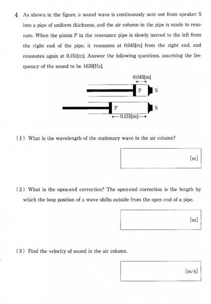

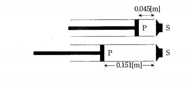

That is a speaker. Sound wave is sent out from spesker S into pipe of uniform thickness.
Piston P move to left
1st resonance at 0.045 m
2nd resonance at 0.151 m
Frequency of the sounx 1620 Hz
Piston is stopped at the position that 2nd resonance occur
Then, frequency increased litle by litle
Find frequency at which resonance occur again
End correction is 0.008 m
##\lambda## = 0.21 m
Velocity = 340 m/s
Frequency = Velocity/##\lambda##
L2 = 0.151 m = 3/4 ##\lambda##
##\lambda## = 4/3 (0.151)m =0.2
Frequency = 340 / 0.20 = 1700 Hz
How to find frequency when resonance occur again?
What will change the frequency, the velocity, or ##\lambda## ?

Notice that your calculated speed of sound does not match the speed of sound given in the problem statement. What are you going to do with the end correction?
Oops. I meant to say your calculated frequency does not match the frequency given in the problem statement.

Ok. I used End correction to find the lambda before.
First. There are 2 resonances occurred at 0.045 m and 0.151 m . With end correction 0.008 m, frequency 1620 Hz, and lambda is 0.21 m.
Then, the piston stopped at 0.151 m
After that, we want to make the sound to resonance again. At what frequency it is?
This is the full version of the question
In case. I gave the question unclear.
And hope the image shows clear too
And number 4
Piston stopped at position which 2nd resonance took place. If frequency of speaker increased little by little at what frequency for resonance to occur again?

Thanks. It helps to have those details. As you said in post #23, changing the frequency will change the wavelength. You have figured out that the first resonance is at ##L_1(λ) = \frac λ 4 - ε## (where L_1(λ) is the length of the pipe and ε is the end correction) and the second resonance is at ##L_2(λ)= \frac {3λ} 4 - ε##. Given a wavelength λ, at what length ##L_3(λ)## will the third resonance occur?
##L_3(λ)= \frac {5λ} 4 - ε##
Right?

You have the pieces you need. You that increasing the frequency will decrease the wavelength. You know the length of the tube, so you can use ##L_3(λ)= \frac {5λ} 4 - ε## to calculate λ. You know ##fλ=v##, so you can calculate frequency.
So, ##L_3## = ##L_2## = 0.151 m ?
##L_3(λ')=L_2(λ)=## 0.151 m
##L_3(\lambda')## = ##\frac{5}{4}\lambda## - ε
0.151 = ##\frac{5}{4}\lambda## - 0.008
##\frac{5}{4}\lambda## = 0.159
##\lambda## = 0.1272 m
But it is wrong. Why?

You have accumulated some round-off errors. I get a nice round number for the frequency.
Should i round the answer to 0.13?
If it rounded to 0.2 m
It will get 1700 Hz nice number

Nope. How did you get 340 m/s for the speed of sound?
Lambda * frequency = 0.21 m * 1620 Hz = 340.2 m/s
With no round-offs, I got speed of sound = ##\frac 4 3 (.151+.008) 1620 = 343.44## m/s. That is not a big difference, so maybe that is not the problem, but it does give a round number for the final frequency.

Maybe
##\lambda## = 0.2 * 4/5 = 0.16 = 0.2 m
That way, frequency = 340/0.2 = 1700 Hz
