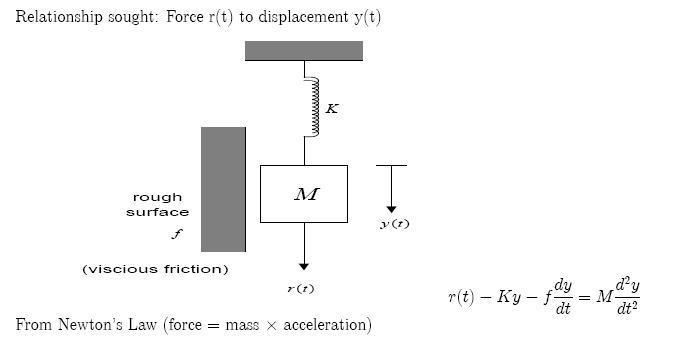

Hi PF frens,
I've got the attached picture translated into differential equation representation.
However, not so sure how the r(t) and f multiply dee-y / dee-t comes about.
Kindly advise?
see attached jpeg.
  • Diagram of a mass M hanging from a spring K attached to a ceiling, with a rough surface f on the left providing viscous friction, an applied force r(t) pulling downward, and displacement y(t) measured downward; equation r(t) - Ky - f dy/dt = M d2y/dt2 shown at right.
Hi there,
From what I can see, the [tex]f \frac{dy}{dt}[/tex] seems to be the friction force applied on the system. I would guess r(t) the simple gravitational pull, but I might be mistaking.
Cheers
