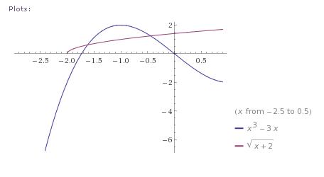

Hi all,
I've tried to no avail to find the solution to this equation in exact form, and I'm giving it up entirely and I hope someone would come up with a brilliant idea on how to tackle it elegantly.
Thanks in advance.:)
Problem: Solve $$x^3-3x=\sqrt{x+2}$$.

3) I should tell that I've plotted the two graphs $$y=x^3-3x$$ and $$y=\sqrt{x+2}$$ on the same Cartesian plane and I knew there are two negative real roots and one positive real root to this problem.

To find the real roots from:
$$x^6-6x^4+9x^2-x-2=(x-2)(x^2+x-1)(x^3+x^2-2x-1)$$
we see that $$x=2$$ is one of the real roots.
And for $$x^2+x-1=0$$, we find
$$x=\frac{-1\pm \sqrt{5}}{2}=\frac{-1-\sqrt{5}}{2}\;\text{or} \frac{-1\pm \sqrt{5}}{2}$$
Checking these roots to see which, if any, are extraneous, we find:
$$x=-\frac{1+ \sqrt{5}}{2}$$ is another real root.
For the third factor, I approached it by using the Newton-Raphson method, and obtained:
$$f(x)=x^3+x^2-2x-1,\;\;f(-0.45)=0.011372,\;\;f(-0.44)=-0.011584$$ and $$f'(x)=3x^2+2x-2$$.
Let the initial estimate of the root be $$x_0=-0.445$$
Thus,
$$x_1=x_0-\frac{f(x_0)}{f'(x_0)}=-0.445-\frac{-0.000096125}{-2.295925}=-0.445041867$$
$$x_2=x_1-\frac{f(x_1)}{f'(x_1)}=-0.445041867-\frac{-2.095301692205461363\times 10^{-9}}{-2.295896943851462933}=-0.445041867$$
Hence, the third real root is approximated by $$-0.445041867$$.
We can conclude now the real roots to this problem are
$$x=2,\;-\left(\frac{1+ \sqrt{5}}{2}\right)$$ and $$x\approx -0.445041867$$.
