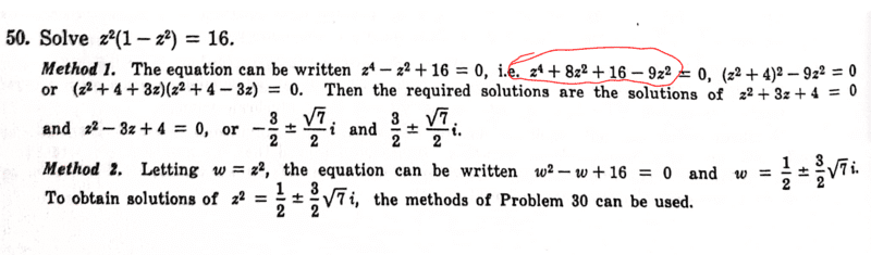

Solve ##z^2(1-z^2)=16## using Complex numbers

The problem is as shown...all steps are pretty easy to follow. I need help on the highlighted part in red. How did they come to;
##z^4+8z^2+16-9z^2=0## or is it by manipulating ##-z^2= 8z^2-9z^2?## trial and error ...
The idea is to make formula of
[tex]A^2=B^2[/tex]
. Let us see.
[tex]z^4+16=z^2[/tex]
[tex](z^2+4)^2=9z^2=(3z)^2[/tex]
[tex]z^2+4=\pm 3z[/tex]
A systematic approach is to factorize [tex] z^4 - z^2 + 16 = (z^2 + Az + 4)(z^2 + Bz + 4)[/tex] and compare coefficients of powers of [itex]z[/itex] to get three equations for [itex]A[/itex] and [itex]B[/itex]: [tex] \begin{split}<br /> z^3 \quad &: \quad A + B = 0 \\<br /> z^2 \quad &: \quad 8 + AB = -1 \\<br /> z \quad &: \quad 4A + 4B = 0<br /> \end{split}[/tex] Since the first and third are really the same equation, we can solve this system to obtain [itex](A, B) = (3, -3)[/itex].
completion of the square
How did they come to ##z^4+8z^2+16-9z^2##?...of course the step after is complete square method...no problem there. Or it was just simply identifying that;
##-9z^2+8z^2=-z^2##
##z^4-z^2+16 = z^4-z^2+16 + 0 = z^4-z^2+16 +8z^2 - 8z^2 = z^4+8z^2+16-9z^2 ##
@malawi_glenn smart move there mate!
And you do this in order to complete the square adding and subtracting the same thing so it fits
