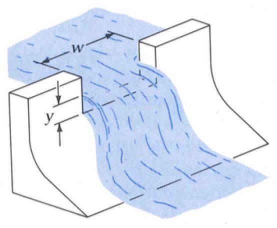

When the level of water in a reservoir is too high, the water spills out over a spillway,
as illustrated in the figure below
Neglecting viscosity, show that the water flow ##Q## over the spillway is given by
$$Q=\frac{2}{3}w\sqrt{2gy^3}$$
[/B]
Bernoulli's Equation: ##P_1+\rho gh_1+\frac{1}{2}\rho v_1^2=P_2+\rho gh_2+\frac{1}{2}\rho v_2^2##
Torricelli's Equation: ##v=\sqrt{2gh}##
##Q=Av=(wy)(\sqrt{2gy})=w\sqrt{2gy^3}##
I am not sure how to get ##\frac{2}{3}## in this equation as indicated by the answer. I feel that I am oversimplifying this by assuming the height in Torricelli's equation is just ##y## when it should account for flow over an area as opposed to a point. Would this mean the height is ##\frac{y}{2}## to get the average velocity of the fluid?
Yes. The consequence for the total flow varies as the height above the spillway increases from0 to y.
No, that's still too simplistic. Consider a thin horizontal slice from x to x+dx above the spillway. What is the flow due to that?
Oh, that makes sense.
##Q=Av=(wy)\int_0^y (\sqrt{2gy})=(wy\sqrt{2g})\int_0^y \sqrt{y}=(wy\sqrt{2g})(\frac{\sqrt{y^3}}{\frac{3}{2}})=\frac{2}{3}w\sqrt{2gy^3}##
Thank you!
Thank you!
Good job.
