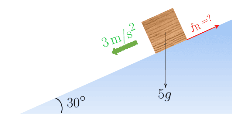

I don't see any drawing of a free-body diagram (FBD). You may copy and paste your own sketch on pen and paper. Better still, there are excellent drawing softwares.
I think an FBD is essential for problems of this sort, specially if you're a beginner.
There you go @galibe, I draw for you the diagram of the problem using MSWord. You need to find the resistive force ##\color{red}{f_R}##. It took a little more than ten minutes.
Please note that I haven't shown all the forces. Can you complete the diagram by showing them?
