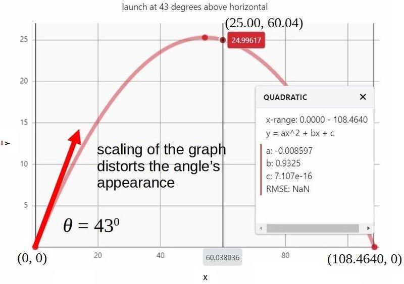

A big thnx to everyone for your help on this problem. As all of you took the time to help out, I thought to share my final solution. Shout out to kuruman for the insight article; it was the crow bar I needed to pry out an answer.
given: ##\Delta y## = 25.0 m, ##\Delta x## = 60.0 m, ##m## = 15.0 kg, ##\theta## = 43##^0##
find: ##v_1##
(1) ## \frac{\Delta x}{\tan\theta - \tan\varphi} = 2\frac{v_{0x}^2}{g}##, ##~~~~~~~~~~##eqn (4)
(2) ##\Delta x = R = \text{ (range)}##
##~~~~~\tan\varphi = \frac{\Delta y}{R}##
##~~~~~v_{0x}^2 = v_0^2\cos^2\theta##
(3) ## \frac{R}{\tan\theta - \frac{\Delta y}{R}} = 2\frac{v_0^2\cos^2\theta}{g}##
(4) ## v_0 = \frac{R}{\cos\theta}\sqrt{\frac{g}{2R\tan\theta-2\Delta y}}##
##~~~~~R = 60.0 ## m
##~~~~~\theta = 43^0##
##~~~~~\Delta y = 25.0##
##~~~~~g = 9.81##
(5) ## v_1 = \frac{60.0}{\cos43^0}\sqrt{\frac{9.81}{2\times 60.0\tan43^0-2\times 25.0}} \approx 32.6593 \frac{\text{ m}}{\text{ s}}##
Now check the work:
Time to top of flight is ##t_{tof} = v_{0y}/g = v_0\sin\theta/g \approx## 2.2075 s
Hang time or free fall time is ##t_{ff} = 2\times t_{tof} \approx## 4.5410 s
The vertical distance ##\Delta y_{tof}## at the top of flight at time ##t_{tof}## is ##\Delta y_{tof} = v_{y0}^2/(2g) \approx## 25.2860 m
Downrange distance ##\Delta x_{tof}## at top of flight at time ##t_{tof}## is ##v_{0x} t_{tof} = v_0\cos\theta t_{tof} \approx## 54.2319 m
Downrange distance ##\Delta x_{ff}## at landing is ##v_{0x} t_{ff} = v_0\cos\theta t_{ff} \approx## 108.4640 m (or simply ##2\times \Delta x_{tof}##)
So the trajectory is a parabola that passes through the launch point (0,0), the top of flight point
(54.2319, 25.2860) and the landing point (0, 108.4640). It should also pass through (25, 60) if this is the solution. As can be seen in the figure below, the parabola fits quite nicely (passes very near (60, 25)), so I am satisfied that it is the solution. Thnx again everyone.

Now that you have a result, the most straightforward way in my book is noting that
\Delta x = vt \cos\theta, \quad
\Delta y = vt \sin\theta - \frac{gt^2}{2}
Inserting the first relation into the second,
\Delta y = {\Delta x}\tan\theta - \frac{g \Delta x^2}{2v^2\cos^2\theta}.
Solving for ##v## gives the required result.
