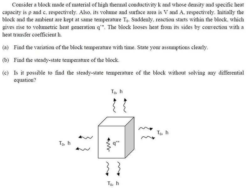

The attempt at a solution
The correct approach is to apply the lumped capacitance method. However, in the lumped capacitance problems I've faced before, it never had a heat generation as it does in this problem.
How do I go about solving this?
Think: The block gains heat at a rate of q and losses heat at a rate which is proportional to the temperature difference between itself and the surroundings. Adding heat to a body, what happens to its temperature?
