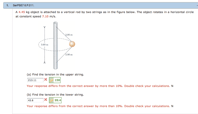

**Hope I don't get in trouble for posting a screenshot of this online homework question...**
[itex]\Sigma[/itex]Fx = marad = [itex]\frac{mv^2}{r}[/itex]
[itex]\Sigma[/itex]Fy = mg
Simple equations allowed me to find r = 1.323m and θ = 41.41°
[itex]\Sigma[/itex]Fx = Tuppersinθ + Tlowersinθ + mgsinθ = [itex]\frac{mv^2}{r}[/itex]
Tuppersinθ + Tlowersinθ + 28.85N = 169.57N
Tupper + Tlower = 212.75N
[itex]\Sigma[/itex]Fy = Tuppercosθ - Tlowercosθ - mg = 0
Tuppercosθ - Tlowercosθ = mg
Tupper - Tlower = 58.15N
Tupper = 58.15N + Tlower
Substituting Tupper,
58.15N + Tlower + Tlower = 212.75N
58.15N + 2(Tlower) = 212.75N
Tlower = 77.3N
Tupper = 58.15N + 77.3N = 135.45N
Good.
In what direction does the weight act?
Away from the pole, so I guess mgsinθ is negative as well?
EDIT: Ah, nope. Fx is only mv^2/r, so I don't need to take into account the gravitational force. Got the answers, thanks for your help!
