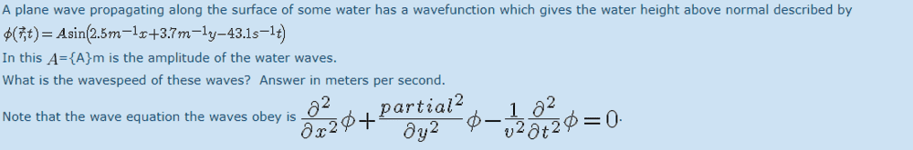

See attached
attached
So I start by isolating v
the speed here would be the square root of the partial t derivative divided by the sum of the partial x and y derivatives.
the amplitude, phi and the cos portion of the partial derivatives would all cancel out.
What I am left with is the sqrt(43.1 / ( 2.5 + 3.7 ) = 2.6359, but the answer is 9.56.
More step by step of my work:
Partial derivative of x is A2.5cos(2.5x+3.7y-43.1t)
This trend continues will all the other partial derivatives with A and cos(2.5x+3.7y-43.1t) being canceled out in the end. This would mean 2.5 is left for x, 3.7 is left for y, and -43.1 is left for t. Phi will also cancel. Now
0=2.5+3.7-43.1/v^2
v=sqrt(43.1/(2.5 + 3.7))
This gives the wrong answer of 2.64.
Did you notice the "2" on all the derivatives??
I think it will be easier if you substitute the given wavefunction into the wave equation, simplify what needs to be simplified and then solve for v instead of first solving for v in terms of the partial derivatives. Also, I would recommend working symbolically with ##\phi(\vec r,t)=A\sin(k_x x+k_y y+\omega t)## to write the derivatives, find a symbolic expression for ##v## and then substitute numbers.
Oh
Whats the "wave equation?"
The one given at the end of the attachment. Presumably the v is the speed you are asked to find. (There must have been a missing backslash in the latex, making ##\partial## display as ##partial##.)
But I think this is what you already tried, but overlooking that they're second derivatives?
I would have figured out the direction of the wave, effectively turning into a wave in one dimension, and taken the ratio of the coefficients to find the speed.
