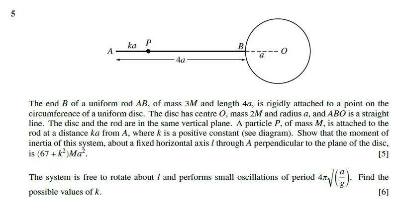

Question is provided

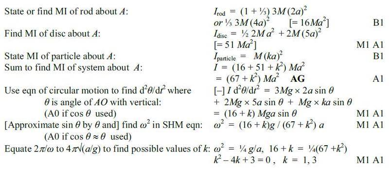

My question is, the examiner have used sine theta in their expression for change in potential. I keep ending up with 1 - cosine theta
Second question is how did they get rid of theta in the proceeding equation
  • Diagram of a uniform rod AB of length 4a attached at B to a uniform disc of radius a and centre O, with particle P on the rod at distance ka from A, with the rod, B and O in one straight line.

  • Worked solution of a rigid-body oscillation problem: moment of inertia of a rod, disc and particle about point A summed to I = (67 + k^2) Ma^2, equation of circular motion giving d^2θ/dt^2, SHM frequency ω^2 = (16 + k)g/((67 + k^2)a), and k^2 - 4k + 3 = 0 giving k = 1, 3.

See the left side. For small angles, ##\sin \theta \approx \theta## and ##\cos \theta \approx 1 - \frac 1 2 \theta^2## (sometimes ##\cos \theta \approx 1## is sufficient).
