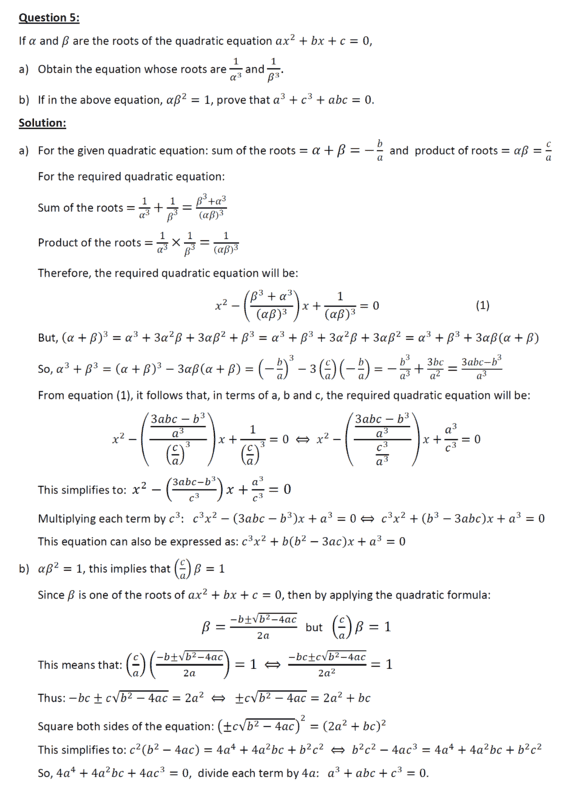

Solving a quadratic equation as a sum and product of its roots
31 replies · 5K views
chwala said:
The approach below is from a colleague, let me know of any other approach to this part of the question.
Your solution is a lot neater than that.
Thanks Perok, it took me a while to think on that...all the passion for this great subject...its a pleasure. I will be posting and sharing more questions...bingo!
