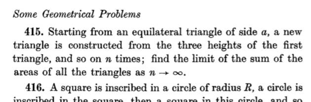

Starting from an equilateral triangle of side a, a new triangle is constructed from the three heights of the first triangle, and so on η times ; find the limit of the sum of the areas of all the triangles as η - > oo.
None
Firstly im not sure if the new triangle that we make of height 3 times the original height of an equilateral triangle of side a, will be an equilateral triangle as well or not.
I assumed it would be, please let me know if I interpreted the question wrongly.
Continuing this train of thought I did the easy part:
The height of an equilateral triangle of side a would be $$ √(a²-\frac{a²} {4})$$ (from pythogoras theorem)
==> $$\frac{√3a} {2}$$
Height of the new triangle would be
$$3(\frac{√3a} {2})$$
Assuming this to be an equilateral triangle as well we know that the side of this new triangle would be x, therefore applying pythogoras theorem once again we get x as 3a
We see a pattern forming if we multiply the new height of this new triangle with 3 and do the same
The general formula for the height would be
$$\frac{3^r√3 a} {2}$$
The general formula for the base would be $$(3^r a)$$
Where r represents the number of triangles we have used to reach the current triangle.
So if we were to write the general term for the summation of its area it would Be
Summation from r=0 to n ($$\frac{(3)^{2r}√3a²} {2}$$)
Taking the constants out leaves us with summation $$3^{2r}$$ inside which I believe is a geometric series
We get
$$\frac{√3a²} {2} (\frac{1(1-(3²)^n)} {1-3²}$$)
If we tend n to ∞ we get this sum as infinite which is not the Answer.
Im obviously very wrong somewhere. Please consider giving a hint. Thankyou :-)

Just realised it most probably means that the heights become the sides of the new triangle...ughhhh
Yes. It took me a little while to come to this conclusion as well. The gist of the problem is to calculate the sum of an infinite series. In fact I believe this is a geometric series, for which formulas are well known.

Heights AKA altitudes. The three heights/altitudes of the first triangle are all the same size, but smaller. The idea is to form a new triangle from these three lengths. You don't need to use any coordinates.
Then do the same with the triangle that was formed to get the third triangle. And so on.
