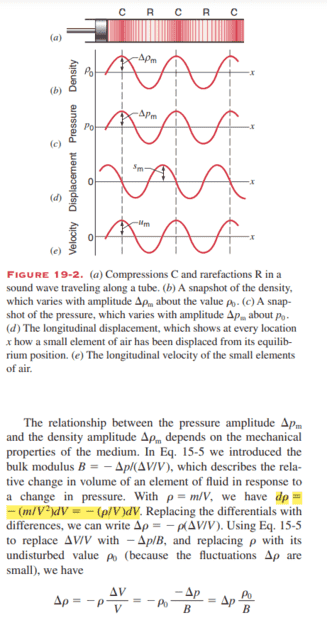

Homework Statement:: This is from 5 ed, Physics 1Halliday, Resnick, and Krane. page 428 about sound waves
I have highlighted the equation that I don't understand. How did the author get it? I understand how they get from the middle side to the RHS of the equation, but I don't understand how they get from the first equation to the middle equation.
I don't have any problem with anything before.
Relevant Equations:: Density: Rho = Mass / Volume
Differentiation.

Orodruin said:
Differentiation.
Is it like this?
dm/dv^2 = - m /(V^2)
so
dp = dm/dv = dv * (-m/(V^2))
No. Use ##\Delta y/\Delta x \simeq dy/dx##
Like this?
##d\rho = \frac{\Delta \rho}{\Delta V}dV##
but ##\frac{\Delta \rho}{\Delta V} = -\frac{m}{V^2}##

Afo said:
Is it like this?
so
Okay, I know why this is false.
It doesn't work since ##\frac{a}{b} = \frac{c}{d}## doesn't imply ## \frac{a}{b^2} = \frac{c}{d^2}.## If that was true, that would mean ##|dV| = |V|## which is obviously false.

Orodruin said:
Do you know how a derivative works?
I am still in high school so this is what I know:
1. We can view ##\frac{d}{dx}## as an operator so ##\frac{d}{dx}f(x) = \frac{df}{dx}## is the derivative of ##f## w.r.t. ##x##.
Another way is to view it in terms of differentials:
2. ##dx## and ##dy## are called differentials. The differential ##dx## is an independent variable. The differential ##dy## is defined to be ##dy = f'(x) dx##
Both ways are rigorous.
So, let ##x = V##, ##y = \rho(V)## and use 2 to relate ##d\rho## to ##dV##.
:doh:Ok, I got it!
##\rho(V) = \frac{m}{V}## is a function of volume and ##m## is a constant.
Thus ##\frac{d}{dV} \rho(V) = \frac{d}{dV} \frac{m}{V} = m\frac{d}{dV} \frac{1}{V} = -\frac{m}{V^2}##
