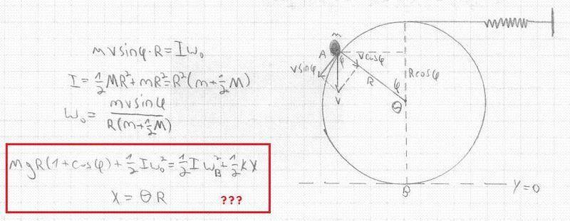

Hey guys.
So I got this disk connected to a spring which is connected to a wall.
A mass m hits the disk with a velocity v and sticks to it.
The question is to find the velocity of m at point A.
As you can see I used the conservation of the angular momentum to find [tex]\omega[/tex] at the beginning.
The thing I'm not sure about is the energy conservation equation I wrote there, I'm not sure about the gravitational potential energy, I mean, is this right?
10x.

I'm not sure I fully understand the diagram, but shouldn't v*cos(squiggle)=0?
Why?
asi123 said:
Why?
That's why I posted that I didn't understand the diagram.
Is the disk resting on the floor at y=0?
Is the disk pivoted frictionlessly at it's center?
I assumed that since you mentioned gravity, that the disk is in a vertical plane.
My assumption was that the disc was fixed on some axis or point and therefore the v*cos(squiggle) component had to be zero. Also, none of the momentum of the mass m would be imparted to the disc as there was no mention of it's mass. So the magnitude of of the velocity of mass m would have to be the same in the direction of sin(squiggle).
Hope that helps.
