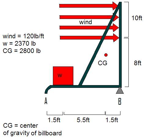

The supporting structure of a billboard is attached to the ground by a pin at B, and its rear leg rests on the ground at A. Friction may be neglected. Point G is the center of gravity of the billboard and structure, which together weigh 2,800 lb. To prevent tipping over in high winds, a 2,370-lb weight is placed on the structure near A, as shown. (a) Compute the magnitudes of the reactions at A and B if the wind load on the billboard is q = 120 lb/ft. (b) Find the smallest wind load q that would cause the structure to tip over.

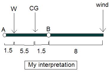

I totaled Moment of Weight and CG and minus it to Moment of wind to get Rxn on Point A... and Add it to get Rxn on Point B.
Am I doing it right? I already answered it using this method and got approx. 15 kNm on point A and 41 kNm on point B, and having 260 lb/ft for the billboard to tip over...
Don't mix up your SI and USA units! The problem is given in units of pounds and feet, so stick with those units.
I'm not sure why you flattened out the vertical support and billboard and made it horizontal. Keep it as shown when summing moments. And the moment arm of the wind force moment is 13 feet, not 8 feet (arm = distance from cg of wind load to pivot point). Please show your calculations. The problem is in 2 parts: first get reactions (in pounds) at A and B, then, for part b, get min q for tipover, which occurs when A = ?

ok here's what I did.
For Reaction on point A:
I replaced the 2 forces (W and CG) with a single force positioned at point A using this equation..
W(7) + CG(1.5) = F(8.5) F = 2,440 something.
Then I reduce the Moment of that F by the Moment of the wind load (pivot is point B)..
F(8.5) - WindLoad(13) = Moment at A.
Rxn on A = Moment at A / 8.5 = 610 lb
is this correct?
Yes, although that's a bit of an unorthodox way of doing it. Why not sum moments of all forces about B directly, to solve for the unknown force reaction at A. Then what's the reaction at B? then move on to part (b).

First I set point A is the pivot. Then I totaled the 3 moments (Weight, CG, and wind).
W(1.5) + CG(7) + Wind(21.5) = Moment A
Then I divided it by 8.5 (the distance from A to B) to get Rxn on B.
Moment A / 8.5 = 5759 lb = Rxn on Point B

No. You can always check sum of forces in y direction = 0 to solve for the reaction at B. In solving moments about A, you again made the mistake of making the vertical member a horizontal one, which gives you the wrong moment arm for the wind force. The arm is not 21.5 feet, it's______feet. By making the vertical member horizontal, that messes up the sum of forces in the y direction also. Don't change the problem.

Firstly, you got part (b) correct. But part (a) is wrong. You can't ignore the moment from the wind force! Moment is force times perpendicular distance from line of action of the force to the pivot. For the moment from the wind force about A, the perpendicular distance from the line of action) of that force to A is ??.. Now check your work by summing forces in the y direction = 0.
