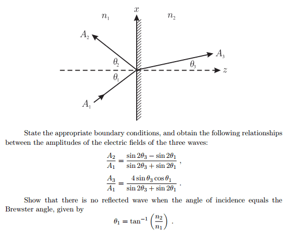

I have solved the first two parts, I'm having trouble with the final part.
Given the following relations, show the following relation of brewster angle:
[tex]tan θ = \frac {n_2}{n_1}[/tex]
Using:
[tex]\frac {n_2}{n1} = \frac {sin θ_1}{sin θ_3}[/tex]
Starting from:
[tex]sin 2θ_3 = sin 2θ_1[/tex]
[tex]sin θ_3 cos θ_3 = sin θ_1 cos θ_1[/tex]
[tex]\frac {sin θ_1}{sin θ_3} = \frac {cos θ_3}{cos θ_1}[/tex]
[tex]\frac {n_2}{n_1} = \frac {\sqrt {1 - sin^{2}θ_3}}{cos θ_1}[/tex]
[tex]\frac {n_2}{n_1} = \sqrt { \frac {1}{sin^{2}θ_1} - ( \frac {n_1}{n_2} )^{2} } tan θ_1[/tex]
How do i show the square root term at the bottom = 1?

Since ##\theta_1## and ##\theta_3## lie between 0 and ##\frac{\pi}{2}##, ##2\theta_1## and ##2\theta_3## lie between 0 and ##\pi##.
One way to solve ##\sin 2θ_3 = \sin 2θ_1## is to have ##\theta_1 = \theta_3##.
But there is also another relation between ##\theta_1## and ##\theta_3## that will satisfy ##\sin 2θ_3 = \sin 2θ_1##.

We need to keep ##\theta_1## and ##\theta_3## less than ##\frac{\pi}{2}##, so ##2\theta_1## and ##2\theta_3## must lie between 0 and ##\pi##.
Sketch a graph of the sine function between 0 and ##\pi##. Draw a horizontal line that intersects the graph at two different angles. How are the two angles related?
[tex]θ_1 + θ_3 = \frac {\pi}{2}[/tex]
OK. Use this in Snell's law.

Ha ha, the answer just pops right out!
