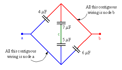

Ah, that helps. They are just trying to confuse you with the way they are drawing it.
Try this... Re-draw the circuit with the 4uF cap horizontally across the top, the 6uF cap horizontally across the bottom, and the two series caps horizontally across the middle. Be sure to keep the wires connected the same, so that the connections don't change. You end up with more of a horizontal rectangular circuit drawing.
Now, do you see some simplifications?

Try this: Identify all the nodes and place a label on them (hint: Nodes a and b already have a label, and there's only one more. Remember that any contiguous wiring comprises the same node). Then make a list of all the components and the two nodes that they connect to. So for example the 4 μF capacitor connects to nodes a and b.
Now forget the original diagram and use the list to construct a new circuit diagram with the same node associations for each component. What do you come up with?

Can you share your list of components and node associations? (If you want you can combine the 7 and 5 μF capacitors into a single capacitor right away, since that combination is rather obvious from the original figure).

Okay, well you've added dots to the top of the circuit, but they are still node b... remember, contiguous wire paths comprise a single node. You can trace a path from your dot to the terminal marked 'b' without passing through any components. So it's still node b.
So, how about writing out that list of components and which nodes they connect to?

It's a node, but it's the same node as terminal b since there's a contiguous wire path from there to b.

Identify the contiguous wire "islands" where components connect. They will be your nodes:

List your components and node associations. The 6 μF capacitor connects to nodes...

Perhaps you might want to do a bit of web browsing, looking up the definition of what a node is?
The drawings already provided have specifically identified the nodes in your circuit. From that can you identify which nodes each individual component connects to? Make a list of components and the nodes that they connect to (assume that the equivalent capacitance for the 7 μF and 5 μF capacitors is one of the components). You should see a pattern.

Try this -- keep the left and right A and B nodes where they are, and mentally rotate the middle part clockwise 90 degrees. Then redraw the circuit in that new configuration, with all capacitor legs horizontal...
