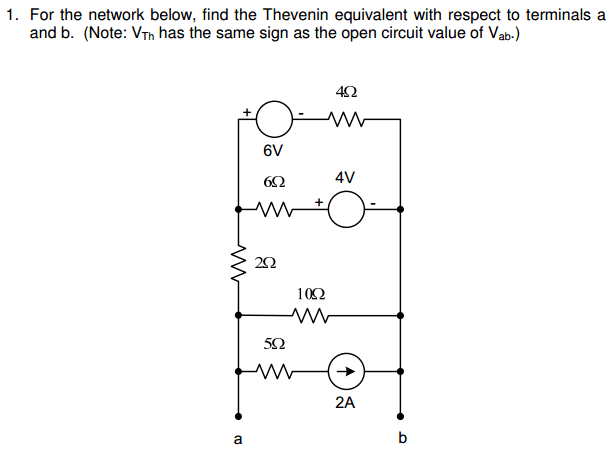

See attached
I found Vth
(V1 - V2)/2 + V1/10 + 2 = 0
(V2-6)/4 + (V2-4)/6 + (V2 - V1)/2 = 0
Solving for V1 I get -5/2 and V2 I get 1
V1 = Vth = -5/2
I believe this is correct. It's just if these two initial equations are wrong or correct. In the first equation I added the current entering the node close to a as V1. I wasn't sure how to handle the 5 ohm resistor.
I choose V2 as the node between the 2 ohm resistor, the 6 ohm resistor and the 6V power source.
I choose the ground reference node to be the whole right side.
I'm not sure how to procede and find the current across the short because drawing a wire to a and b results in a huge essential node.
Thanks for any help.

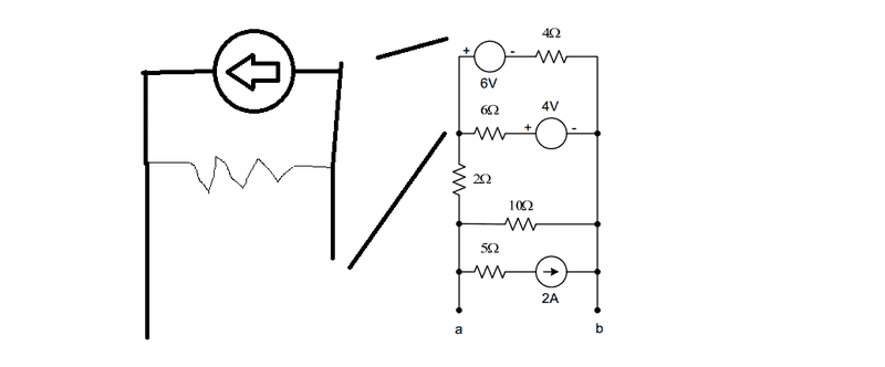

So I do something like this.
Where the resistor I drew has the same resistance as the resistor next to the 6V source (in this case 4 ohms) and the current source is just 6/4 A or 3/2 Amps?
Yup. Do the same for the next voltage source/resistor. You should then be able to combine them into a single current source and resistance...

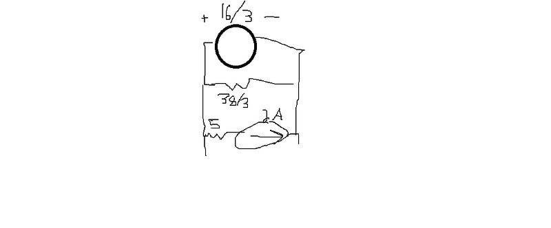

This is what I get
what do I do from here?
Is it a voltage source of 380/53 with a resistor of 190/53 in parallel?

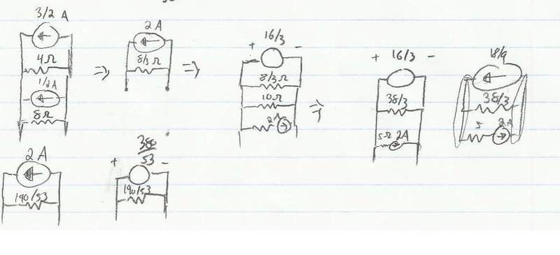

It seems odd that you'd end up with a voltage supply in parallel with a resistance if you've been doing Thevenin/Norton reductions along the way. Can you outline the steps you've taken to get there?
Ya
see attached
Okay. A Thevenin model is always a voltage source in series with a resistance. A Norton model is a current source in parallel with a resistance. If you convert a Norton model to a Thevenin model, the resistance is the same value, and vice versa.
I see from your attachment that the second voltage source, 4V with 6 Ohms in series, has been turned into a 1/2 Amp source with 8 Ohms in parallel. That's not right. The 2 Ohm resistor is NOT in series with the 4V supply. Only the 6 Ohm resistor is. So turn the 6 Ohm resistor and the 4V source into its Norton equivalent. Then combine the two parallel Norton models into one. This in turn can become a Thevenin model with a series resistance that can take then take the 2 Ohm resistor on board.
